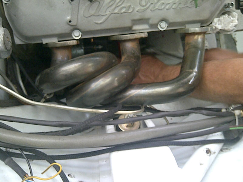

More pics. Well all i can say is these branch manifolds require the engine to be lifted off mounts if you want to take them in and out hence I have never used them for road use .

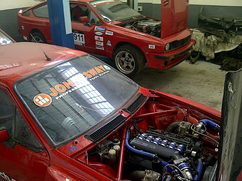

Re: GTV 3.0 12v motor restoration with mild modifications
My Car is now at Powermods and sitting in good company amongst these seriously fast twin turbo GTV's. These are owned and raced by brothers Domingoes and Jose. And keeping it in the family younger brother Paulo will wire in the new harness now that I have removed the old one .
The 24v TT produces double the power of the 12v TT but thats only a 2.8.
Always interesting stuff in this workshop .
- powermodsworkshop.jpeg (129.2 KiB) Viewed 13454 times

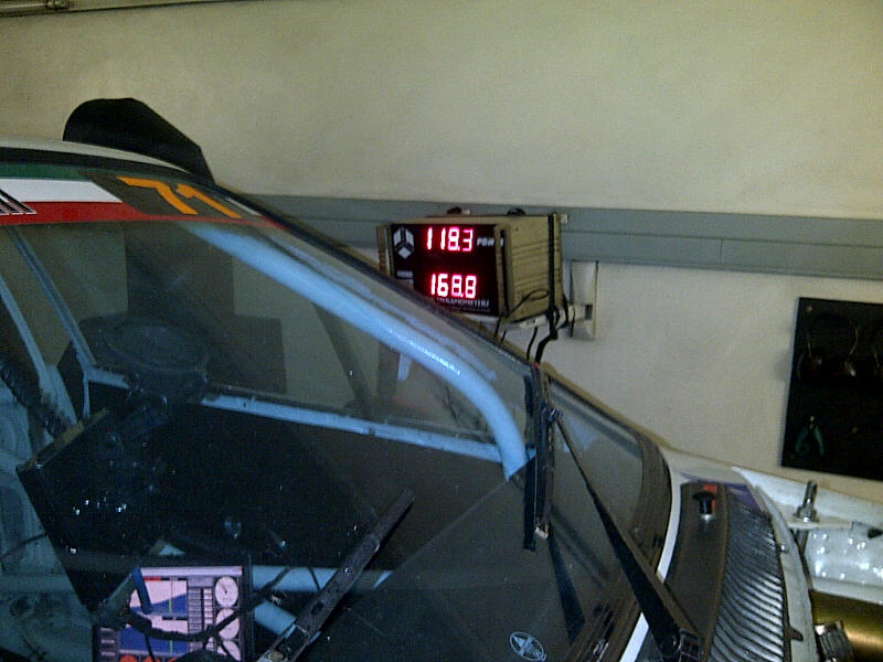

Some snaps of Dyno run
- Powrmods software Dyno snap shot
- kevin 37 dyno.jpg (71.24 KiB) Viewed 13347 times
- Kevin's dad making sure all ok :)
- kevin 36 dyno.jpg (61.61 KiB) Viewed 13347 times
- kevin 35 dyno.jpg (79.65 KiB) Viewed 13347 times
