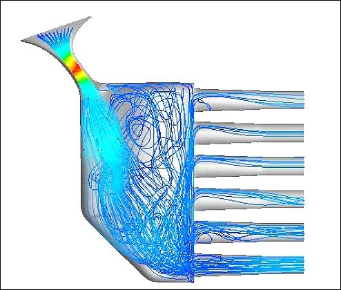

About the "extractor style" manifold, the inlet of the runners look awful. Notice in my video linked above how the air in the plenum is pretty much standing still in between when the different intake valves are open and how the primary flow into the runners are from the volume right next to it. I noticed a big improvement in flow balance between the runners by moving the ends further away from the #1 and 4 runners. A 10mm move made a HUGE difference, imagine having a wall right next to the runner like in the "extractor", it will be bad compared to a larger volume and a proper bellmouth, also "crosstalk" between the runners will be a big factor when you cram all of them into a small area like that with a very small volume of air to work with.
The CFD plot above look typically like a static flow through all the runners, as in all valves are open the vhole time, not like any piston engine I know of. Quite useless as a design evaluation.
