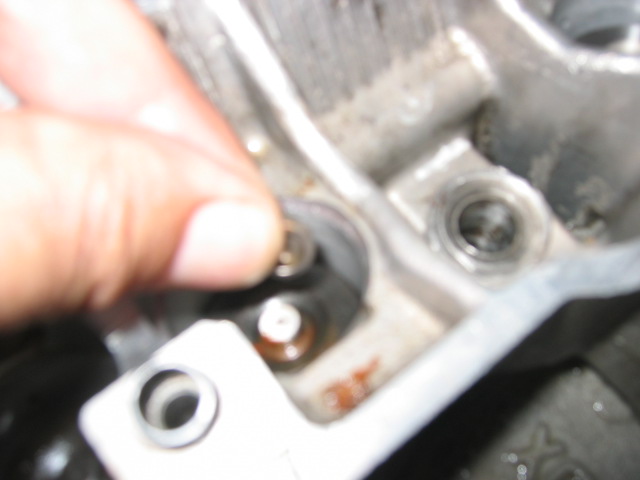

There is a pic, bit blurred to show a tiny 1mm shim that goes onto valve before origional hydraulic lifter goes on top.

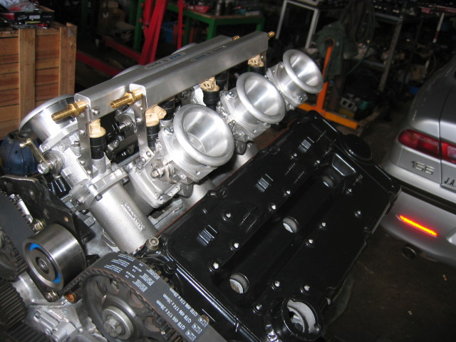

Up date on my 3.7 motor. I ran it in slowly for 100km unti I noticed bubbles co ming into water bottle when you rev the motor which only meant one thing - LEAK. This leak only occured when engine was cold, but I retorqued up to 88nm according to manual and absolutely no problems 1000km later. According to gasket manufacturers these gaskests compress 10%. Have no idea what power its making but its a good ten car lenhts ahead of my 3.0 24v 164 by the end of secong gear !

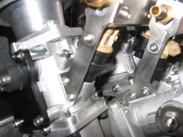

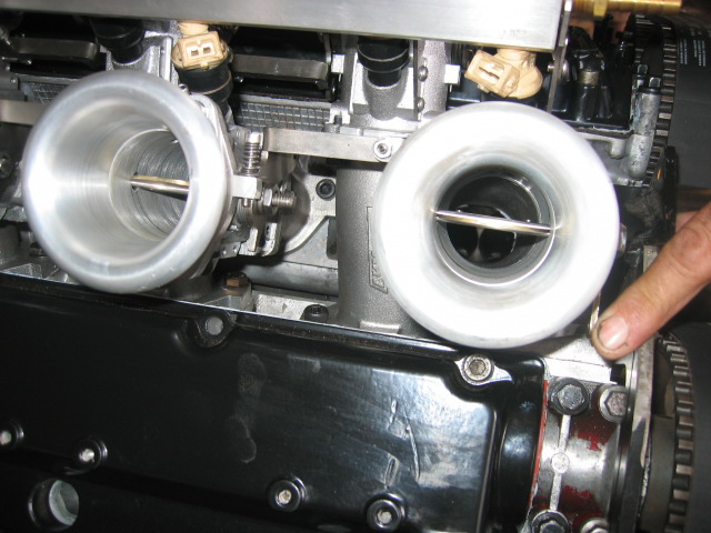

Here are some pics of a real 3.7 24v from Glenwood. Why i say real is that it has used better rods than I have, higher compression, propper porting, individual throttles etc. Zamani here the rest of pics

Nice looking engine, is those throttel bodies from AHM in the UK??

Doc, the intake runners are from AHM in uk but the throttle bodies and trumpets are local.

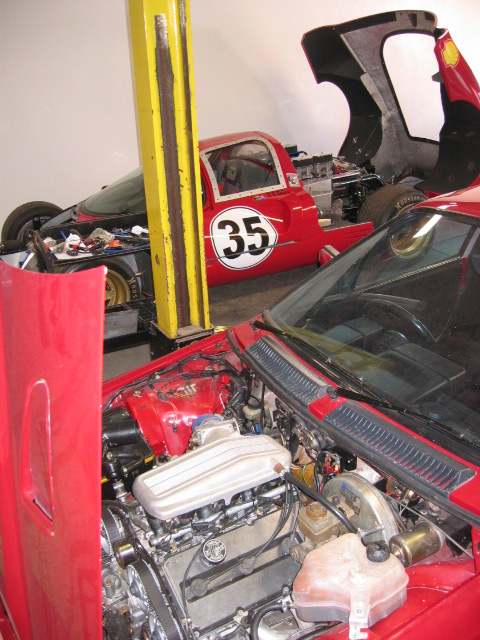

Some updates already mentioned in ''Track and race car preperation ''.
Moved plenum to sidemount to make it interchangable with race car. Car is very reliable just need some cold start mapping.

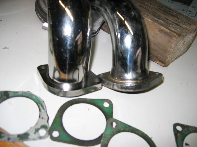

Some interesting pics of plennum tubes 43mm versus 45mm. The actual gasket which joins tube to intake manifold is the same part number on all the alfas from 2.5 24v to 3.2 24v. Alfa made the port diameter large to start off with. See pic of both tubes and how the 43mm tube has been 'stretched'.

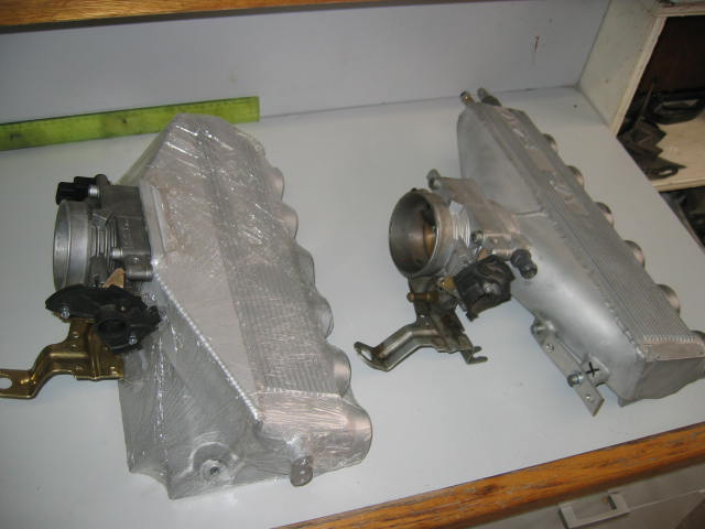

Just out of interest , I got exactly the same power output on dyno with the centre plenum which was made from two smaller ones as compared to the new side plenum with the long GTA runners. What I did notice was removing the airfilter on this set up gave me extra 8 kw . I found this previosly with old airbox hence I changed it. So now the trick is to find a less restrictive airfilter. This is the pic of the old centre plenum

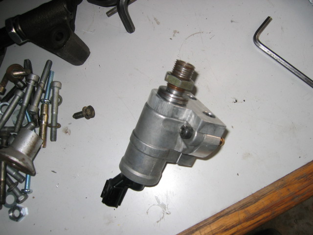

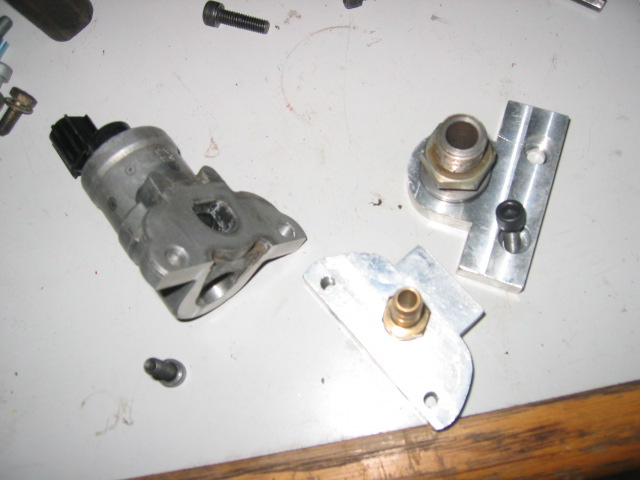

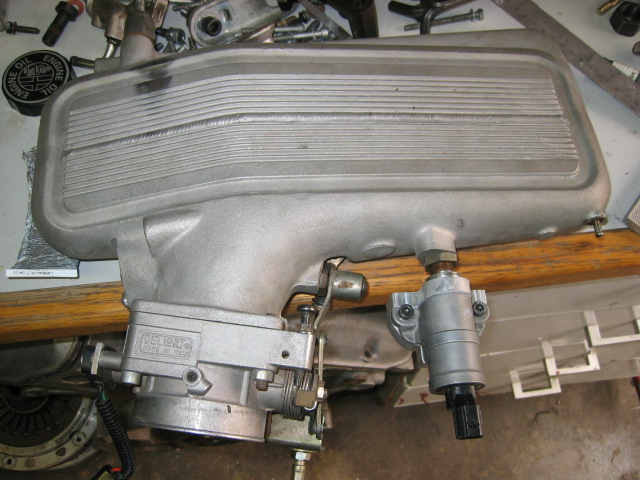

Made a adaptor for two pin idle control valve from a ford. in order to seal had to machine both face as . Was worried to tap into it. Works perfectly with new Gotech pro x.

The stock airbox has a very badly designed exit pipe, has anybody tried to make that better and kept the rest of the box?
Arn't you worried that thing will crack from the vibrations?

I was talking about the Idle valve...
