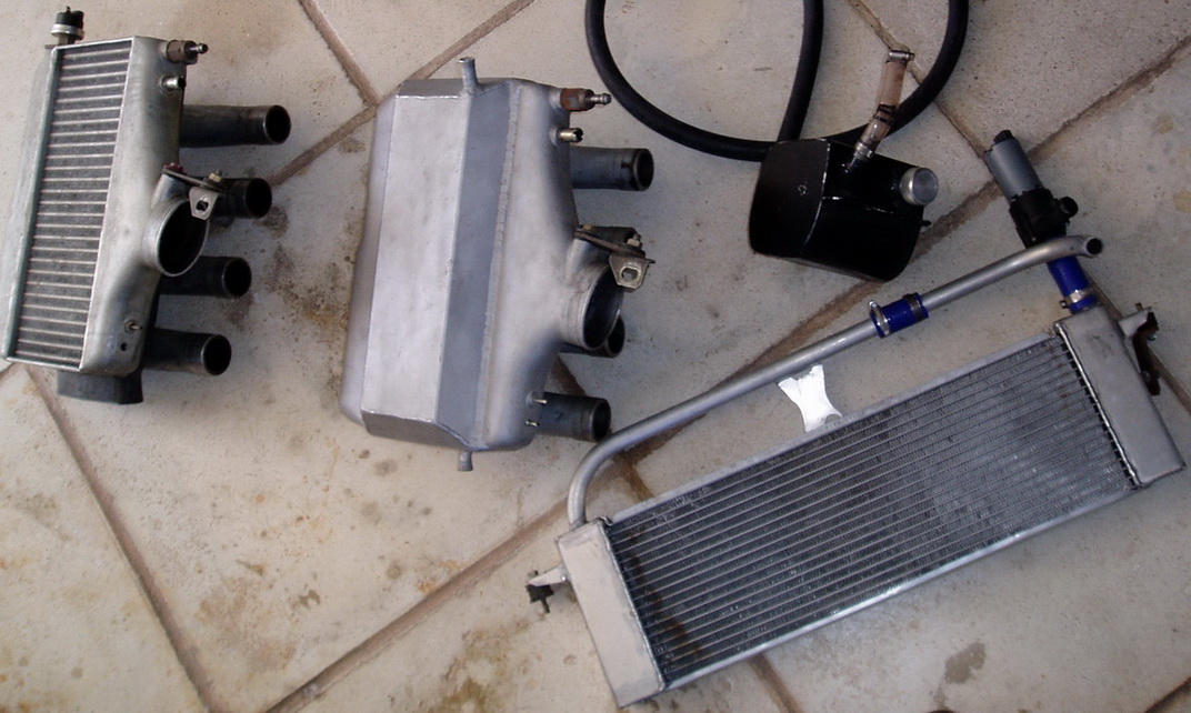

Ok, enough off-topic BS, let's see what's new on the 1.8T front... Past couple of days I spent putting in the water/air IC, its front mounted radiator, expansion tank and recirculator pump. System capacity is 6liters, a good volume for this application. I also installed the IW-44 injectors (measured at 294cc). Before starting the engine I of course checked for water/ fuel leaks by running the recirculator and then the fuel pump. All ok, so I started up and reduced fuel pressure to ~3bar. Measured and set idle CO to 1% and took it for several test runs on the 'uphill dyno'. No pinging at all in 2nd/3rd/4th gears flat out, afr 10.5-11.5:1 wide open at 1.5bar with 1.8bar overboost. I wanted steady 1.6-1.7bar but seems the wastegate opens up on me, damn! I even bent (shortened) the rod by ~3mm, same thing. I'll have to check further; maybe need a stronger spring in the bypass (dump valve). Tomorrow morning I'll resume testing and I may even remove the wastegate input...VERY CAREFULLY! Anyway, the intercooler housing goes no higher than what I think is ~30-45*C. I'll find some means of measuring intake temp. So far so good, I am actually happy with the result. If it gets any better, I'll call for a dyno appointment.

Jim , any pics of the front mount Water/air intercooler. Please remind me what you did on head gasket .

Kevin, the head gasket is a 2-piece std production item with separate steel O-rings from Nava, pn 80029. http://www.navalineasport.it/eg/catalogo_eg.htm
Head is milled 1mm for 8:1 from std 7.5:1. Note this is the 75 1.8T engine, NOT a 2liter. With these gaskets, 2.5-3bar is no problem. However, we've seen liners split at ~3-3.2bar though.
Here's a pic of the std IC, the modified one, the top tank and the radiator with the recirculator pump showing connected to one end (15liters/minute). System capacity 6liters.

A guy over here that works a lot with these kind of chargecoolers told me an easy solution for the front radiator. He said an airco hetaexchanger works quite well and they're nice flat and available in many sizes. :)

Aren't the water in and outlets on the chargecooler not a bit to tiny, they look restrictive compared to the other connections (front radiator and pump)!? Or are those other connections at the back side and front site of the charge cooler?
