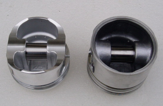

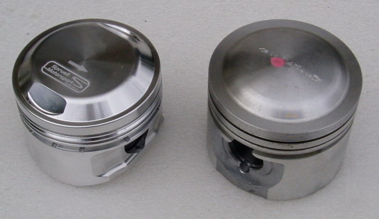

Its been a long time since some new hardware has been presented anywhere for the 1.8T engine. Well, after some deliberation with Paul Spruell and CP, here is a new forged piston for these engines, which will accept the well-proven factory rings. Slight valve cutouts are evident and CR is 8:1 (std CR is 7.5:1). Weight is 448gr, 11gr less than the std items. Here are a couple of pics from the first production set I got yesterday next to a std new piston. P.Spruell has been instrumental in seeing this project through and he plans to delve further into the 1.8T and TS parts world soon.

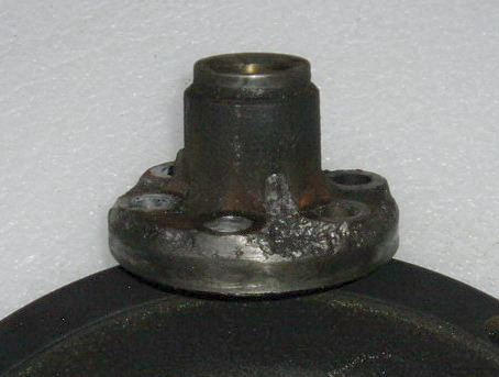

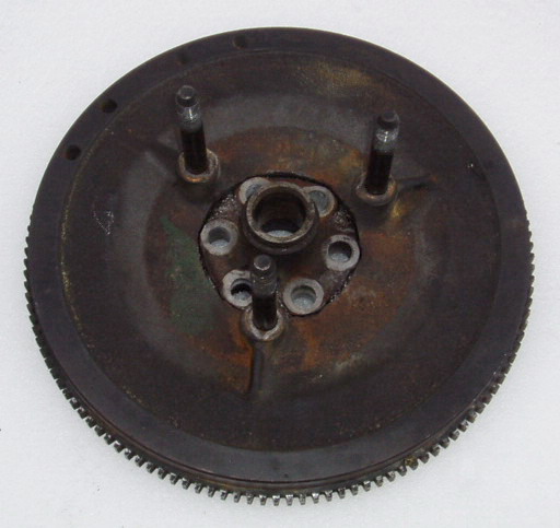

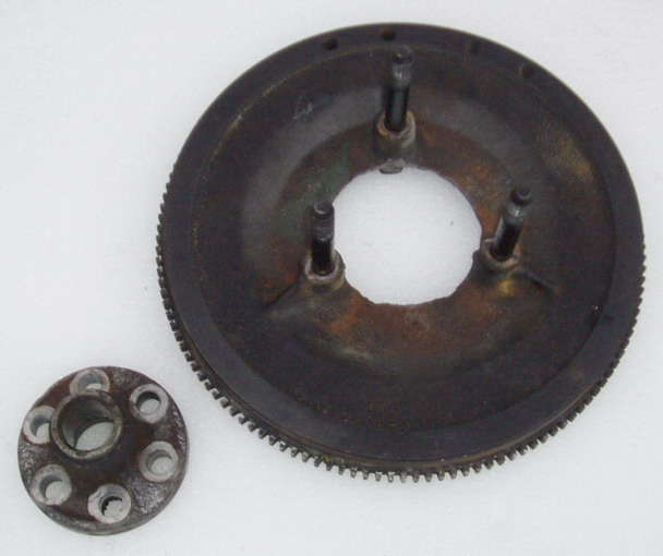

Ok, we all know the 1.8T can make lots of power. If components are not up to par, things sometimes break, but I didn't ever think I would see something like the pictured item! The particular 1.8T has ~280 wheel hp and 38kgm (275ftlbs) of torque. The owner loves stoplight rubber and apparently the std flywheel has had enough! I am amazed at the way it btoke! I suppose too much traction did this but G.Gordon would know more about this! :wink:

Re: 4-cylinder turbo performance
And this is why I always warn people about drilling holes in a cast flywheel...
Imagine that happening at 200Km/h, it would take a while before you think to depress the clutch I'd say...
Pistons look sturdy, looks like quite a lot of squish though, comments?
