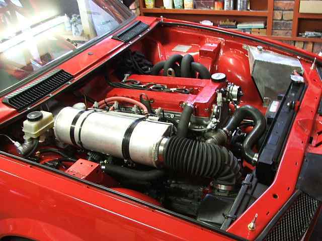

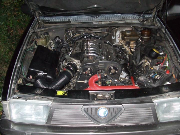

This is what I did. 164 intake. but I moved the butterfly to the front.
and made it look as stock as I could.
if I ever go boosted it will plumb right to the inter cooler

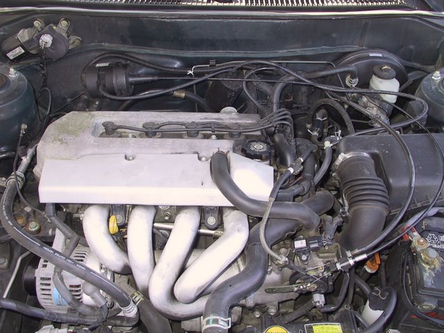

I was thinking about this style of manifold design and tripped over this picture in my web travels. Basically a set of equal length exstractors (inductors or 'inducors'
) for an inlet manifold.
To me it makes logical sence, air traveling towards the inlet runners should have more natural momentum rather than being forced to make 90 degree turns to try and find it's way into the inlet runner. Each runner is in the same relationship with the plenum chamber and throttle body. I'm seeing an imroved design over a conventional log style plenum, but this system is hardly used, tho I do recal seeing a similar approach on a Mazda B6 or BP 4 cylinder, too.
Purely a cost thing? Lack of real world bennefit?

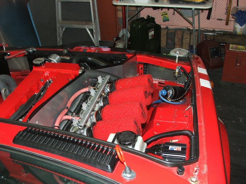

What you see is not what you get and this stuff of intake plenums produces outcomes that can be unexpected.
For instance, the filtered induction set up with the plenum in a static situation on the engine dyno produce 15hp less than when the car was on the move on the track. Both the plenum and the socks over the TB's produced the same power on the move where the socks setup now lived in a much larger virtual plenum consisting of the inner guard and bonnet.
you figure it out...

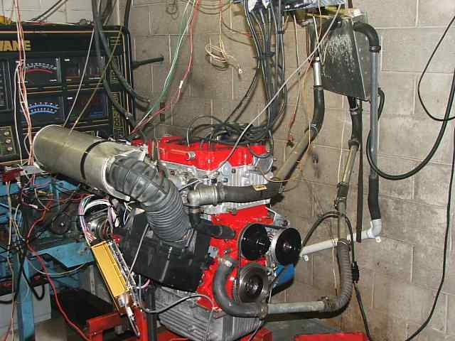

Re: Inlet Manifold Design
Yeah hi Buddy,
The filter for the plenum is not the 105 type. It is a card filter and sits in a VL Commodre black box with its arse cut out and facing direcly into the wind behind the dummy front rhs headlight. On the move this would create a positive pressure in the plenum but not sufficient enough to call it any form of supercharging. The air temp sensor was fitted to the filter box.
For clarity, the fully filtered +plenum made the same horsepower based on lap times as did the no plenum and red socks with segregated hot/cold engine bay zones.The temp sensor was in the same position for both to all intent and purpose.
The difference in what I am saying is that in a static situation with the engine on the engine dyno and using the plenum and filter, it made 15hp less ie. on the move = +15hp at standstill = 15 less.(same set up).
So when it comes to testing your design, you may incounter some quirks is what I am saying.
Hey Kevin, note the large diameter pulley on the alternator.
Incidentally, that single coil on the inner guard is there only to fire the Veglia tacho I was using at the time. It didn't want to know anything else. Both are now history.
- TS engine on dyno fully plumbed up.jpg (47.6 KiB) Viewed 9486 times
