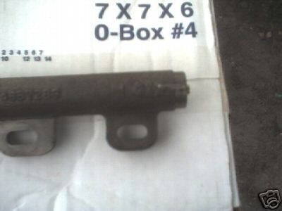

does it apply enough force to keep the belt in place if you can compress by hand?
sounds more like a spring/piston combo rather than the stiff oil dampers like mitsubishi had on the Eclipse..you had to comperss them slowly in a vise and then insert saftey pin..
mitsu belt tensioner
slyalfa
Posts: 88
Location: Milpitas CA
Post by slyalfa »
Sounds the same. you can not push in it by hand. you need a press or a vise.
and it also has a pin to hold it closed to install the belt.(not needed as you just bolt it in on the camery)
My guess is is the same inside just a different mount.
The jap cars have very long timming belt life so the oil filled spring units must work well.
