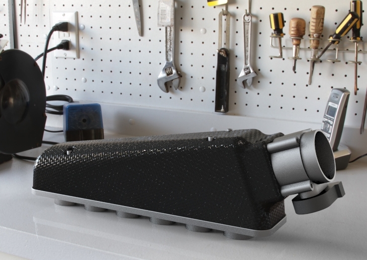

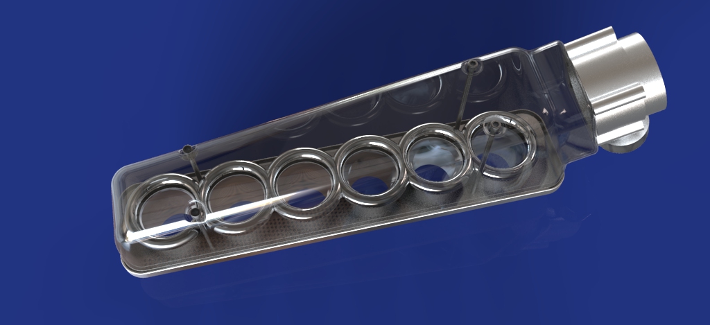

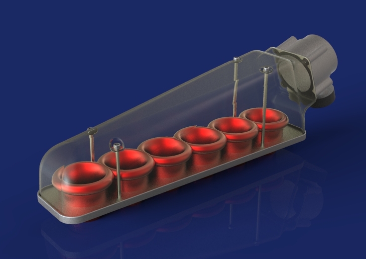

found these on line
looks ok for the gta except maybe a bit small
- GTA Plenum Carbon Moulded.160.jpg (135.17 KiB) Viewed 18971 times
- GTA Plenum Carbon Moulded.154.jpg (121.8 KiB) Viewed 18971 times
- GTA Plenum Carbon Moulded.152.jpg (243.31 KiB) Viewed 18971 times
Re: Inlet Manifold Design
Looks too tight, when simulating my plenum it was obvious that the volume in direct proximity to the inlet runner is most important to flow. I.e. if there is no volume of air there will be less air going into the runner.
Looking at the picture above the last runner (on the left) is boxed in by walls in four directions three sides and a "roof". The other runner next to it will not help either. Just doubling the width and adding 2-3" after the last/before the first runner will help flow considerably. The height over the tunner is actually less important.

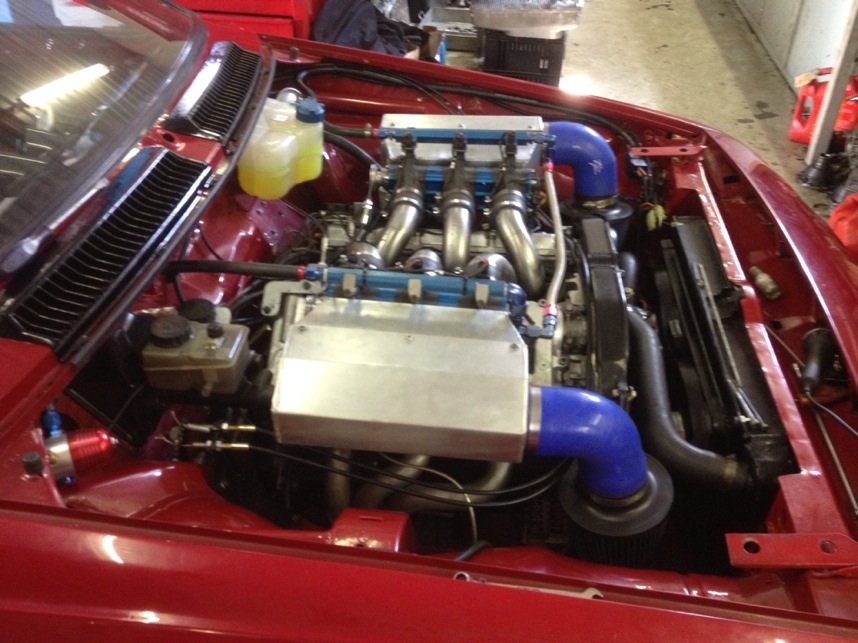

If we talking front wheel drive this is good option . Look at the size of the pipe coming into the chamber and compare that with the above pics . You can't really guage how high the dome of the chamber is .
thanks for the info Mat was thinking of something similar but bigger..
3.8 litres for a 3.22 and I guess bigger if I get the 3.6 to work...
the issue I have with the other picture is the shorter ram stacks.. ok for a full race 8000rpm/9000rpm full race monster but i think the existing ram pipes need another few inches for a road motor but didnt want to add bends so was thinking a big as possible inlet further away from the existing ram pipes with maybe an adjustable length for testing until I find the optimum given the space constraints
let me know what you think or if experience says different

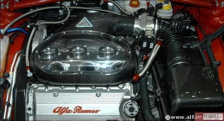

Mats mentioned a good point about extending the plenum. Look at the plenum of the Ferrari F12.

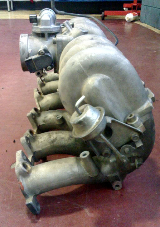

after some stripping and measuring the inlet pipes on the 3.2 156 and different lengths between banks
around the 30mm mark..
so thinking on staggering the inlet ram pipes by the same amount to equal the pipes lengths up..
would this be an issue having an unequal length ram pipe or would this benefit the design overall
got some nice ram pipes sorted 46mm diameter
staggering them would leave the bell mouths complete also
opinions please if you would be so kind..

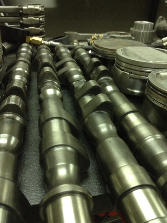

While I was in SA last week I heard the shrill from this motor with barrel throttles from Dawies engine at Glenwood . As the barrels open the aperture gets bigger from centre ( obviously) and does not have the turbulence of the butterfly in normal throttles .
I see Dawie is using these beautiful Newman cams . Checks the overlap on the lobes . Just what Jim has been preaching in his graphs . These cams come in over £1100 .
I think this car is coming to UK as a fun trackday car .

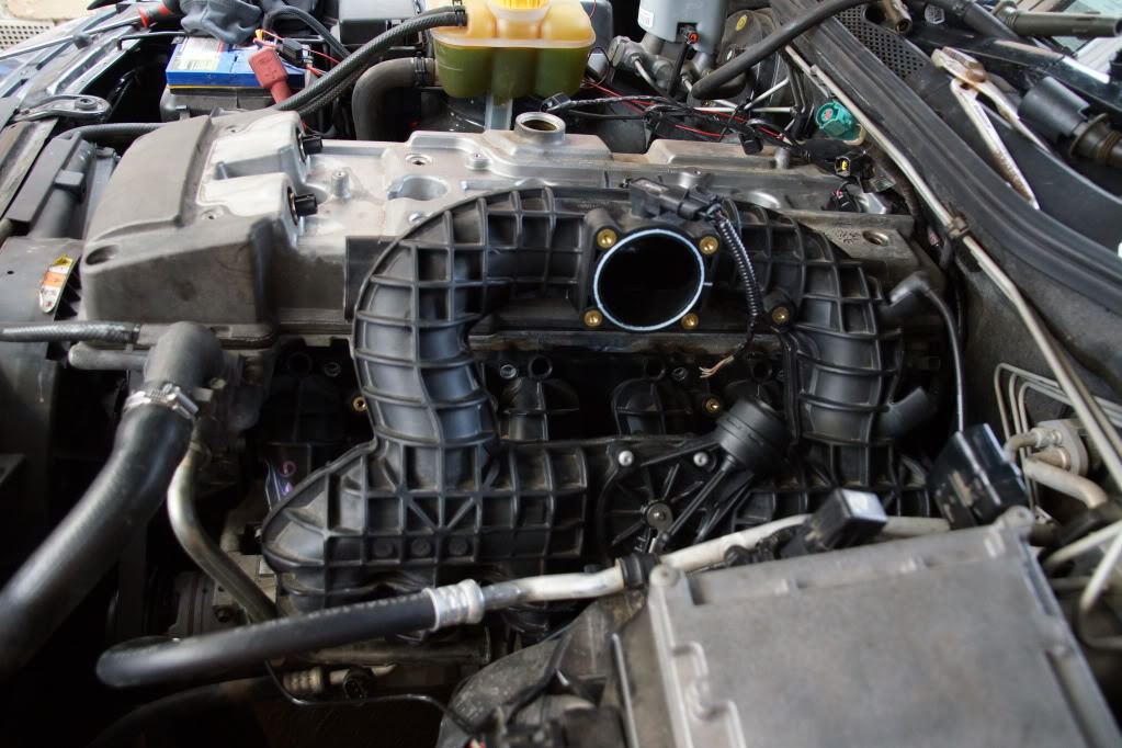

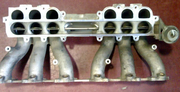

So giving this old thread a bit of a rattle...............
What are peoples thoughts on the types of variable resonance manifolds and their effectiveness?
For a pair rather different exampes, Ferrari went from its previous dual length manifolds in the F360 and F430 to its divided plenum chambers with interlinking valves in the 458. These are obviously engines with both high operating speeds and with excellent power per litre.
Closer to home (Aus), Ford Aus went from its old dual length manifold that they started using in the early 90's to a divided pair of plenums, again with an interlinking valve, on their 4 litre straight 6s.
Having said that tho, Ford Aus weren't exactly quick to impliment changes. The dual length manifold was developed for the single cam, 2 valve per cylinder engine. That same basic manifold layout stayed on the twin cam 4 valve per cylinder engines that also sported dual continuous variable valve timing.
The long stroke Ford 4 litre is never shy of low RPM torque output, but is no revver and its specific power output isn't exactly impressive.
yeah i guess that has to be advantages of the duel length plenum but if they are outright power or more low down torque or just emissions or needed with variable cam shaft timing i,m yet to get conclusive facts..
