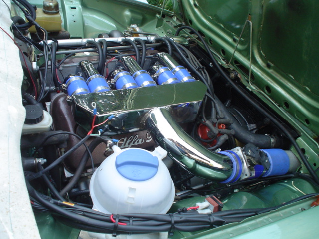

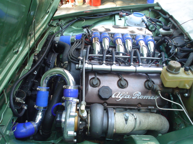

I made an 3.0 V6 turbo for an '00 GTV TB using almost same methods as you.
I use 2.0 V6 TB block bored to accept 164 3.0V6 liners and pistons, Lancia thema heads and cams so it has same piping layout as GTV does and Garrett GT3076R turbo. Pistons are shaved 1mm off the top so CR is about ~8.3. Stock fuel injection with 390cc injectors.
Runs actually quite nice so i'm planning similar engine on my alfa milano using megasquirt'n spark :D
