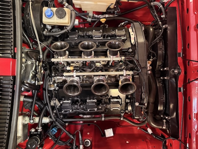

The Jenvey’s are really designed for the front wheel drive Alfas to fit under the bonnet hence they are sooo short. Ideally on the 24v when placed in the transaxle should have a longer runners with throttle bodies each side above the cam covers .
This is a current project leading on from the throttle body set up which we have just done on the 3.0 Carb heads . The new throttle body set up I will a mere spectator this time :)

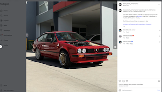

Hi to all, Mine are Jenvey throttle bodies on my 3.2 24v and the engine runs like a dream.
Alfaaa1
Posts: 130
Re: V6 12v Individual Throttle Body
Post by Alfaaa1 »
If you go to Instagram and type in boost_tech_performance, and click on the photo you can see the film clip of my engine being dyno tested.
