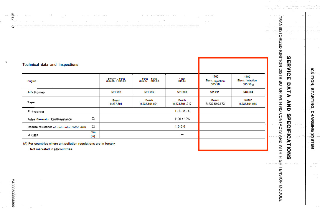

I cannot find the 33 version from which that bosch number u gave (0237507009) originates...
service manuals gives 2 other numbers : 237.540.173 for regular 1.7ie and 237.601.014 for 1.7ie for markets with catalyst converters and emission regulations... the models with hall sensor... LE Jetronic injection...

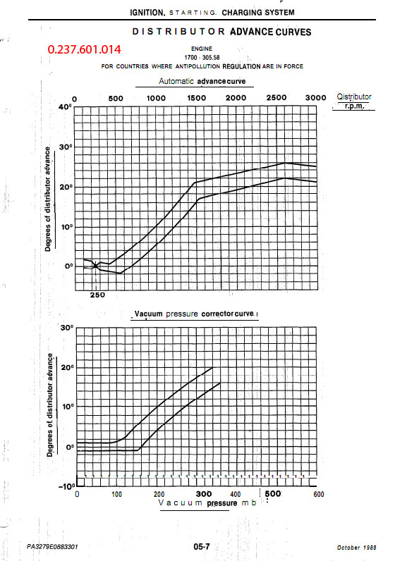

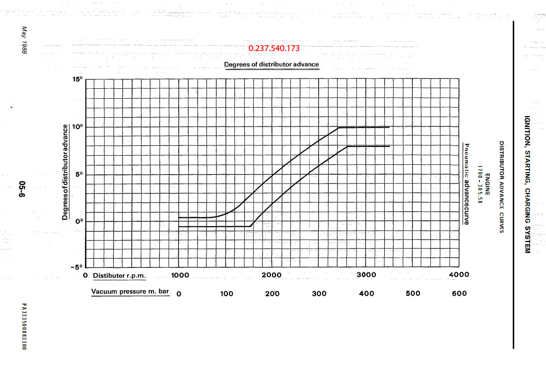

now, the one that is only vacuum regulated goes up to 10* so in normal cruise with part throttle u have about 4-5* advance...
could that make problems if the pedal was sharply depressed at lets say 5500 rpm... and u get instant 5-10* advance at that rpm? even dangerous for the engine?
these are the respective curves: the "regular one" without automatic (mechanical?) advance: and the catalyst, polution regulated one, with advance:

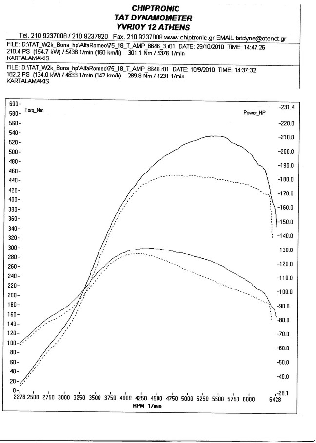

Well, I went to the dyno again today and I'm happy to arrive where I wanted for an everyday driver: 210hp at 5400rpm and almost 31kgm (224ftlbs) at 4400rpm are very respectable numbers, so I’m declaring the end of power mods for this car, as the other 1.8T will see a lot more changes. Sure, not everything is perfect: afr still goes weak after ~5k but I can live with that. I may investigate -just for the hell of it- if it’s the injectors maxing out or the adjustable regulator playing games. This power was made with an average boost of ~1.2bar (17.6psi) which is very safe and comfortable with the entire setup. I had to finally settle for 4*BTDC at idle, to totally forget about pinging. I believe these results to be close to the max potential of the stock management system. Note also that the intercooler is still where the factory put it!
Here’s the dyno sheet showing the before and after curves. Remember the ‘before’ curves were made with 1bar (14.7psi) boost.

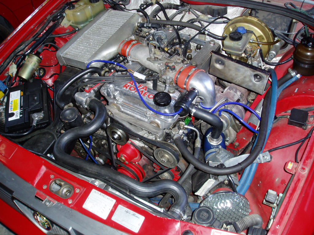

- Alfa 75 1.8T with limited mods and 1.2bar boost.
- 1.8T 27-10-2010.jpg (95.53 KiB) Viewed 10014 times

those are great hp numbers jim!
what turbo are you using?

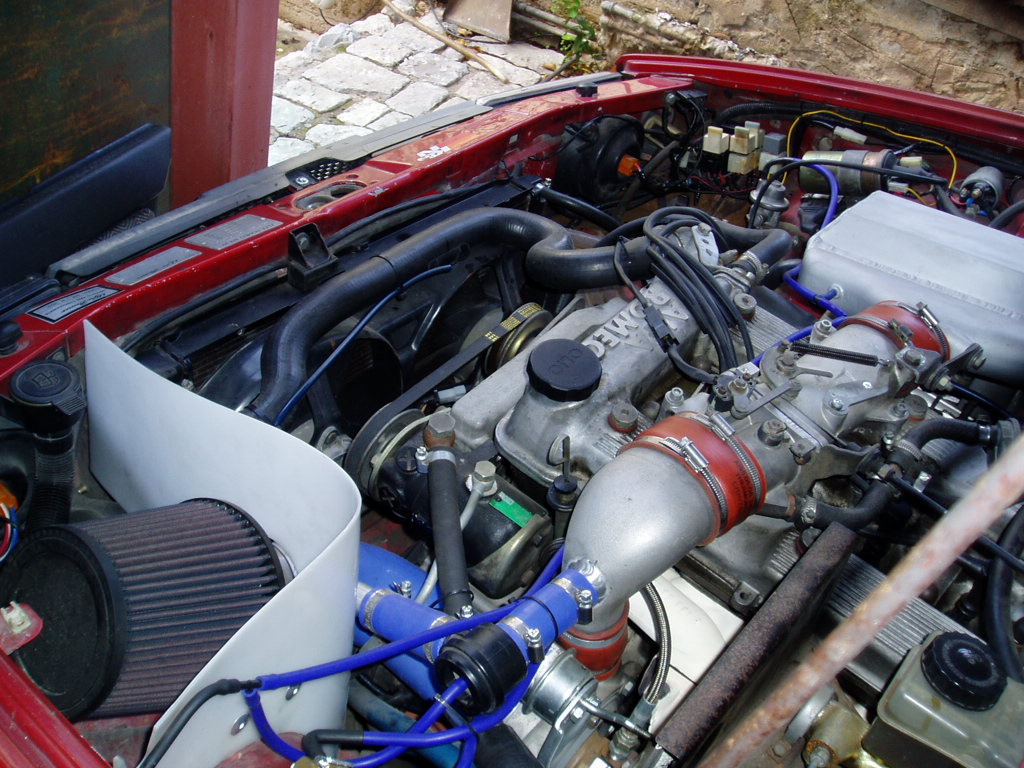

Maybe the most practical solution is to install the large radiator from the Alfa 75TD cars along with the twin fans. I have this in the other Turbo as shown in the attached second pic. A friend with a 75T with the same system, has 287 rwhp at 1.8Bar (26psi) and never exceeds 85*C in the track even in the middle of summer. My car will be similar spec in a few months and I'll be able then to have more detailed info. Notice also the water/air intercooler, the radiator for which is behind the bumper; flow is via a small water pump.
The first picture is from the daily Turbo.
- Daily driver 75T with cost effective mods.
- PA310008.JPG (215.18 KiB) Viewed 8851 times
- Track/road 75T in the making.
- PA310006.JPG (220.28 KiB) Viewed 8850 times
