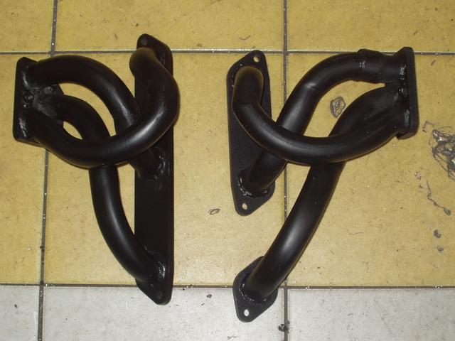

Jarle those look AMAZING!!!!! :shock: :shock: :shock:
They look alot bigger than the CSC or IAP headers! Are you planning on making a few for profit or is this a Jarle Special Edition?

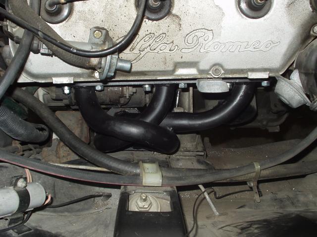

81GTV6:
I think these will be my own spesial edition, as the making of these just takes too much time. I am not sure how many hours I have spent making these,but its a LOT.
As you know there is very little room on both sides in the engine bay, and the fitting requires modification on both engine block and chassis. Thats probably why CSC and the others only make ID35mm.

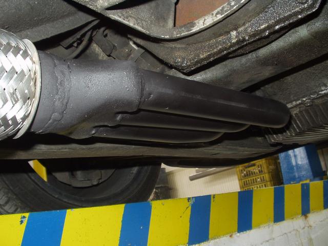

I was a bit "envy" of your headers, so I had mine made by an exhaust shop. 8)
Since my engine is stock, I' ve chosen the ID35mm pipes, and it was made CSC style. Rest of the system is CISAM OEM middle, and ANSA rear muffler.
How do you like it?

Jarle, What did you exactly needed to do with the chassis and engine block to fit those big bore headers? Do you already have an estimation of the power gain?
