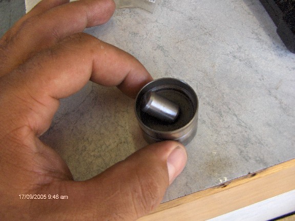

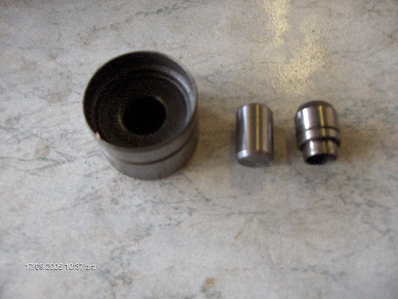

With a shift in conversation to revs, it is worth mentioning that there are other issues with the 24 valve; hydraulic lifters that float at some point! In the 3.7 we went solid - see pic...!

nice trick...dismantle the hydraulic one to make it solid...
for the guy tooled its a good way to reduce costs.
very very good trick...never heard about even so easy.
easy easy......how did you dismantle the hydraulic part of the lifter ?
i remenber theres just a few room to work/grab/pull/explode the thing

Nice flat, hard, solid surface - cup your 3 middle fingers and hold the back of the follower (between 2 & 4, with your middle finger on the back of the lifter - whack the open end on the steel surface REAL hard and FLAT 2-3 times! (Do not use pliers etc - you may want to use them again...) Make sure to hit FLAT! After the 10th/11th/12th one the joints in your fingers start to ache. After 18 gout sets in! By number 24 you're done with that hand for a week!
Now you need a HUGE variety of forged steel, chrome molly "bullets" to set the clearances - just like shims in a 12 valve shim-bucket/cam-follower - cams in and out, in and out - the same "old" story...

i just try it on an old tappet, works fine...junglejustice wrote:Nice flat, hard, solid surface..................
also i'm running on 0.5mm cam/hydraulictappet when collapsed. dawie says that this can handle something like a solid tappet below 8000 rpm, but after..solid really required, to keep things solid instead of soft hydraulic, and also because of the weigth of hydraulic tappet.
