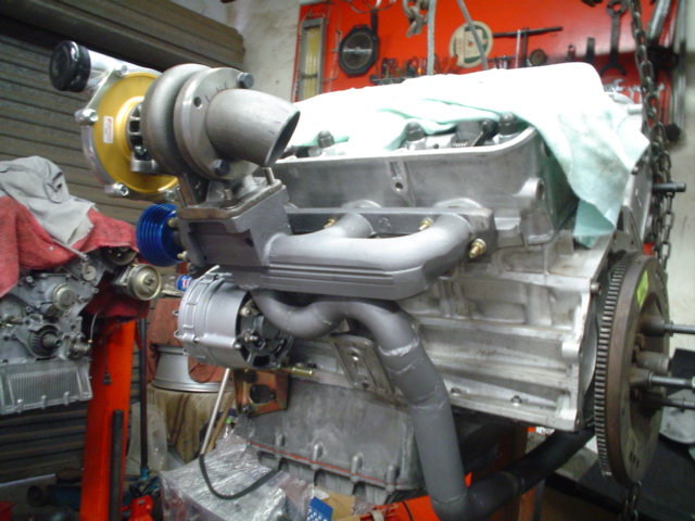

Nearly as tight as a fishe's arse and they are water tight... :D

barry i must say very nice work there. having done a similar setup i understand how hard some things can be to fabricate so in my book you get a thumbs up from australia. he he he. now bring on the vidssss :)

Thought Id update this ...This is the original Giulietta turbo and the gtv20l car thats now getting the 30l turbo...
will post pics of the other 2 when I can..

Wow ,very nice!!!,
I suppose the manifold's complex fits in on engine-out jobbies, great piping direction!
Is the greyish colour of the piping a cermic coating?

Hey Chen,Sorry,missed this post..No the grey coating is simply a 600 deg. C paint coating...It actually lasts very long considering the temps involved..
It just looks so much better than a rusted up piece of pipe...
Once its baked on,it becomes a powdery coating that will come off untill,well,untill it doesnt anymore! :D :D
Does not mean its all gone,it just burns the excess off.
Just awesome Barry! How big is that exhaust pipe out of the turbo? Is it a lot of work to get the pipe down and out the bottom of the car? I love the exhaust manifold. It looks like it will last forever.
Greg,Its 73mm I.D. .The down pipe fits beautifully and exits with no hassles at all...Thanks.The manifold is cast iron and super reliable..As Ive said,this is No:17 that Ive done.

:shock: :shock: :shock:
Is this pipe from Spaceshuttle? :lol:
Very nice! 8)
Looks like someone has a pretty well heated steering rack... :)
Mats,Your correct there.It does get rather warm around the rack..
The pipe gets wrapped with a heat blanket.The stuff i use is discarded JT9d jet engine kevlar insulation..
believe it or not,there is still at least 50mm air gap between the rack and the pipe!!

Still can't exactly figure out where the rack is though, I thought it would be in between the cross-under (? 8) ) pipe and the downpipe but then I can't se how the 3" pipe fits between the body and rack. :?
I know my 3" downpipe is pretty close to the rack and engine mount but the cross member the rack is mounted to is pretty tight up against the kink in the sump.
