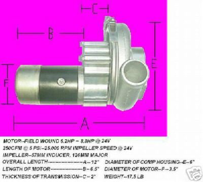

Post by TS_turbo »
it is posible to el-supercharge ... but not with PC fan-like device :D
here is example ot working el charger ... but for few minutes of work it need 2 huuuge 24bateries+some thick cables in the trunk :lol:
