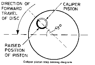

ive been reading up on the rebuild of front/rear gtv6 brakes and have noticed some say that the pistons need indexed to the correct location....what is the "correct" location?

You mean the cutout in the piston? I have a picture somewhere... :?

I believe that this is what you're after.
CALIPER PISTON ALLIGNMENT.gif (2.66 KiB) Viewed 19323 times

thank you thank you thank you thank you thank you thank you :D
:wink: Errrm,Murray,thats for the rear calipers.....
But it just so happens to be applicable to the fronts as well... :D :D

Hey Barry educate me.How can you tell it's for the rear ? I didn't even realize the rears had the raised ridge on the pistons...time to crawl under the car :evil:
Barry Henning, you are staying after class and you will write on the board 100 times: I will not lie to my classmates :oops: ! The rear pistons don't have cutouts, the pads are specially shaped to cater for pressure distribution. I am really disappointed...our star student...see where smoking in the toilets got you? :roll:

Mmmmm,so right Greekster... :oops: Im thinking Sud calipers,hence the drawing..

Ah ,well,back to class...(I actually went and checked on a caliper here Jim... :shock: )
