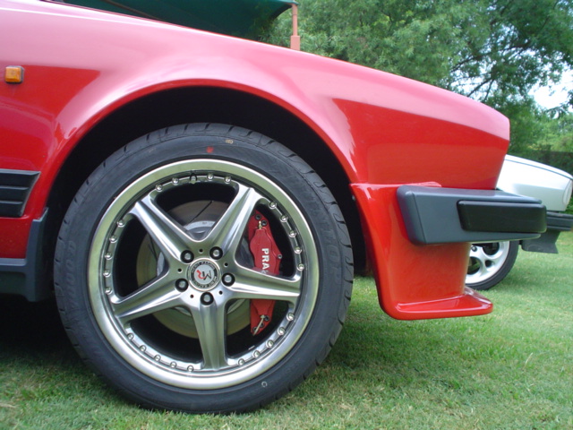

Finnished Kevins gta \116 brake setup.8pot up frnt on std. gta discs.Nothing fancy.Damn,these things work like crazy.
I know everybody knows how to do these,but the 8pots actually do fit into a 15" rim on a 310mm disc...........................
Kev went for 17`s though.
- Dsc00430.jpg (143.08 KiB) Viewed 17475 times

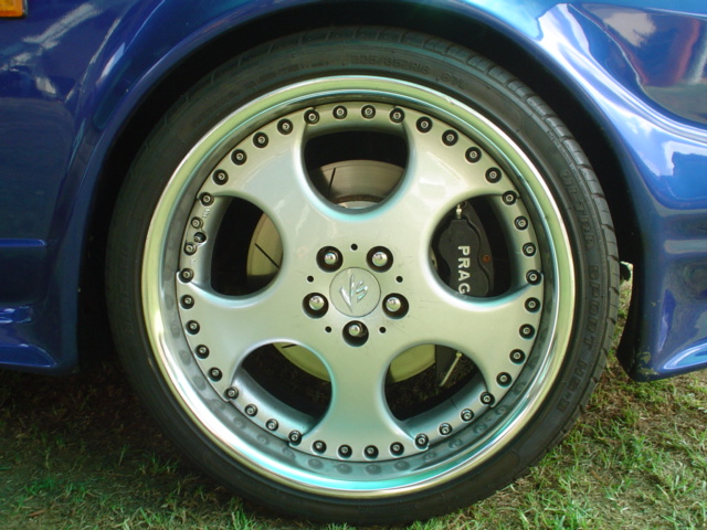

These are the 6pots also on gta discs.Work just as well as the 8`s.
The nice thing was that these setups cost less than R 7000.00 all in!!
- Dsc00418.jpg (141.58 KiB) Viewed 17474 times

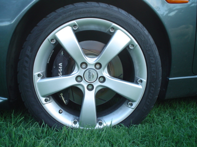

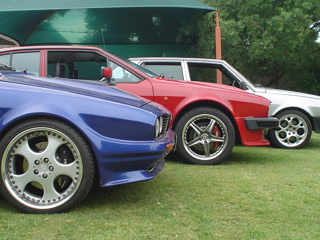

The Giulietta is fitted with Brembo 4 pots,
the red gtv with the 8 pots
the blue gtv with the 6 pots.
- Dsc00425.jpg (148.72 KiB) Viewed 17473 times
- Dsc00285.jpg (147.16 KiB) Viewed 17471 times
