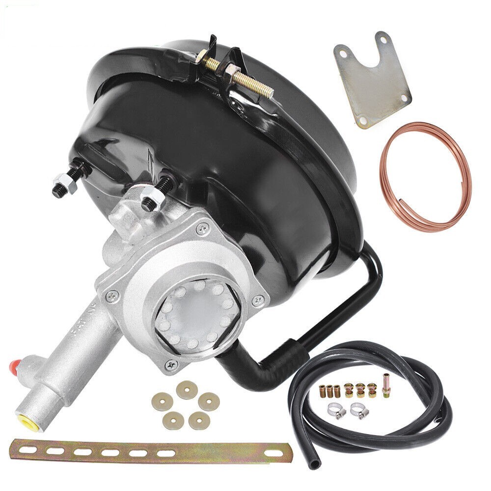

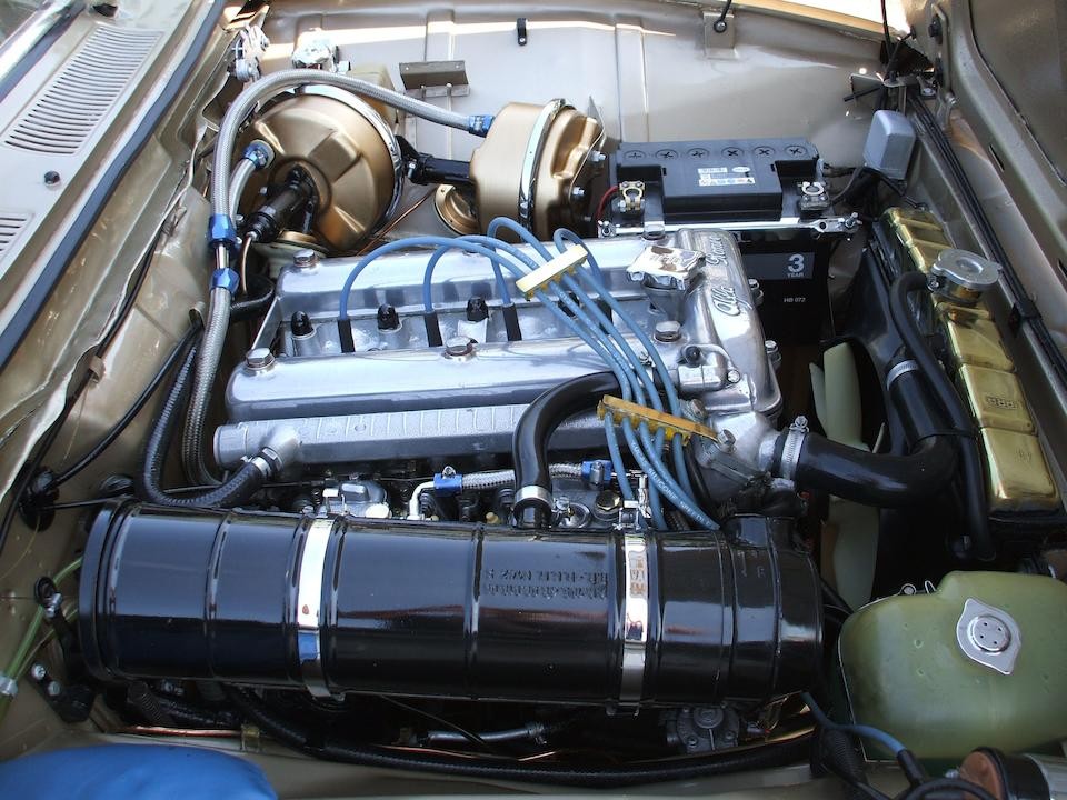

Consider two VH44 inline vacuum boosters. One for the front circuit and one for the rear. Much like the 70's 105 sedans used.
- Berlina VH44 boosters.jpg (146.07 KiB) Viewed 18264 times
- VH44.jpg (127.67 KiB) Viewed 18264 times
