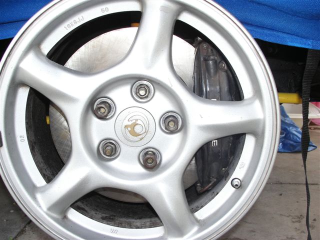

I was not able to make adaptor brackets for these calipers to make them fit inside a 15' rim so I made aternative brackets which I probably would not suggest but have lasted two seasons of racing. See thread. Imsure if some one thinks outside the box for a design I can get a few made.
viewtopic.php?f=21&t=2048&st=0&sk=t&sd=a&start=210

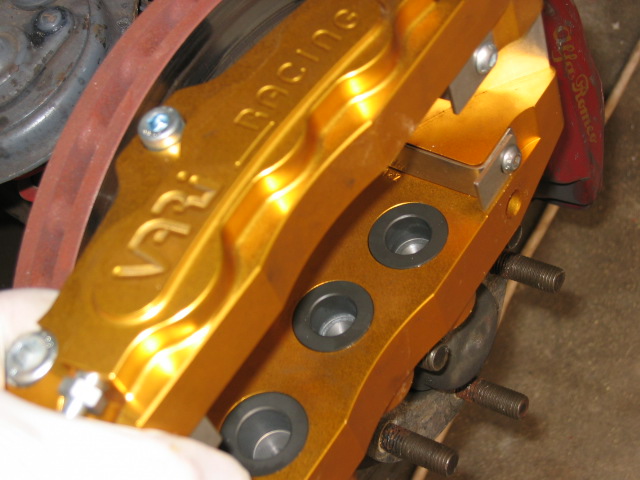

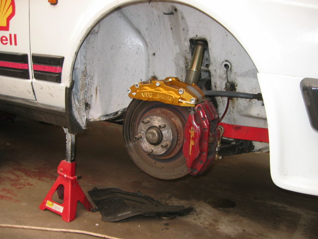

Im ready to change brakes on race car to these VARI calipers which are made speciffically for a race series here, so they have been thoroughly tested and use an off shelf Performance Friction pad. There is no flex in these calipers and are nothing like some other annodised calipers posted previous on this forum. If 15 inch rims were not a prerequisite than i think it would be pretty easy to make a bracket for the Brembos and I would continue to use them. These calipers are 20mm narrower per side which will give more room for 315mm gta disc.
Check pic -

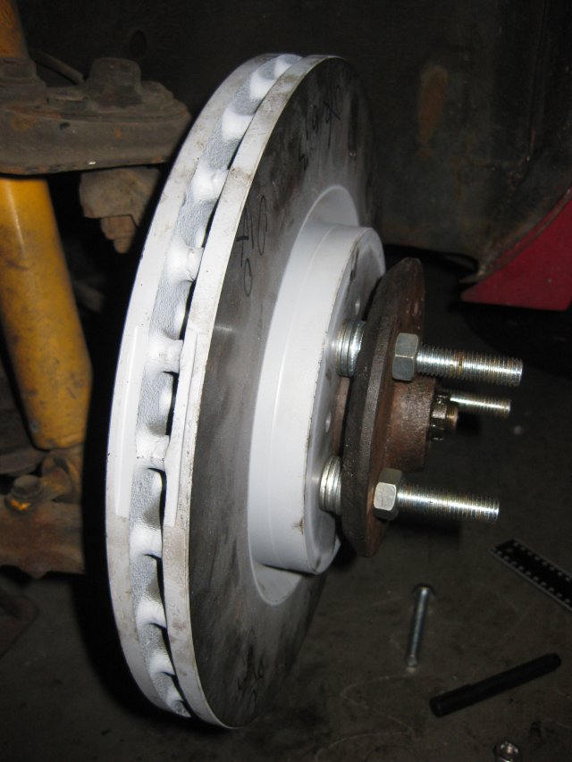

I was checking this weekend how the Alfa 166 caliper would fit. Hmmm, not quite...

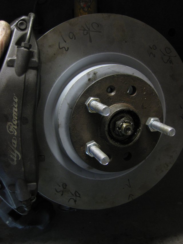

I first made a roughly 10mm spacer in between the hub and disk.
10mm spacer for GTA disk.jpg (79.98 KiB) Viewed 10551 times

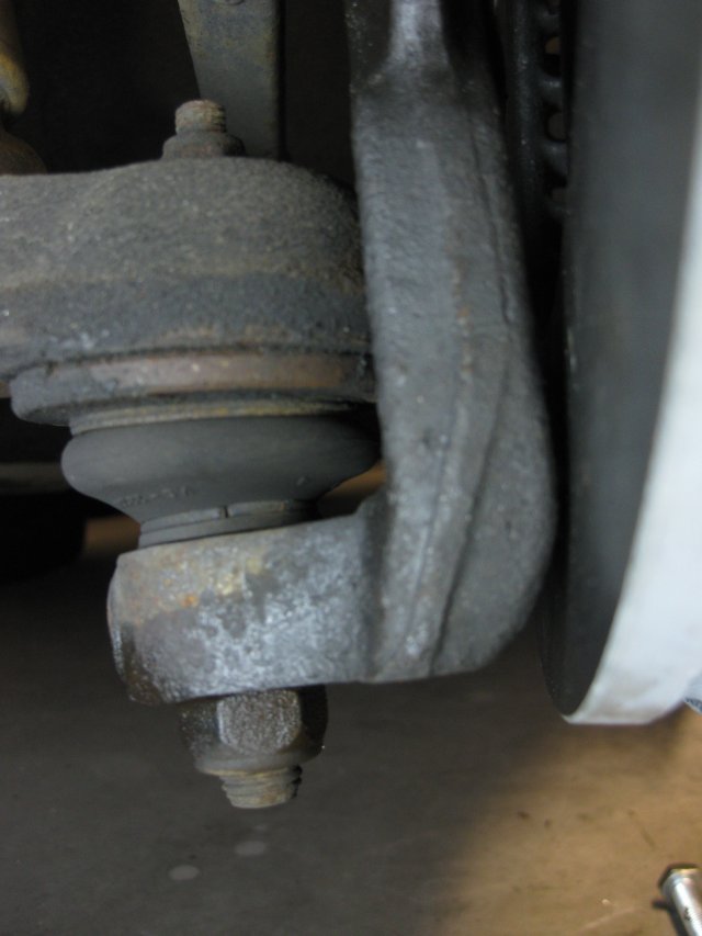

You can see, there is hardly 1mm gap between the disk and the upright.
1mm gap between upright and disk.jpg (60.84 KiB) Viewed 10551 times

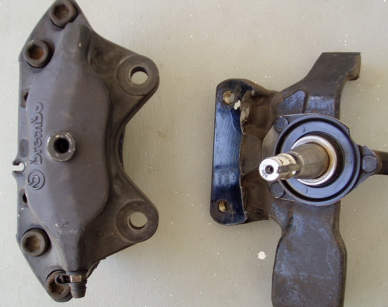

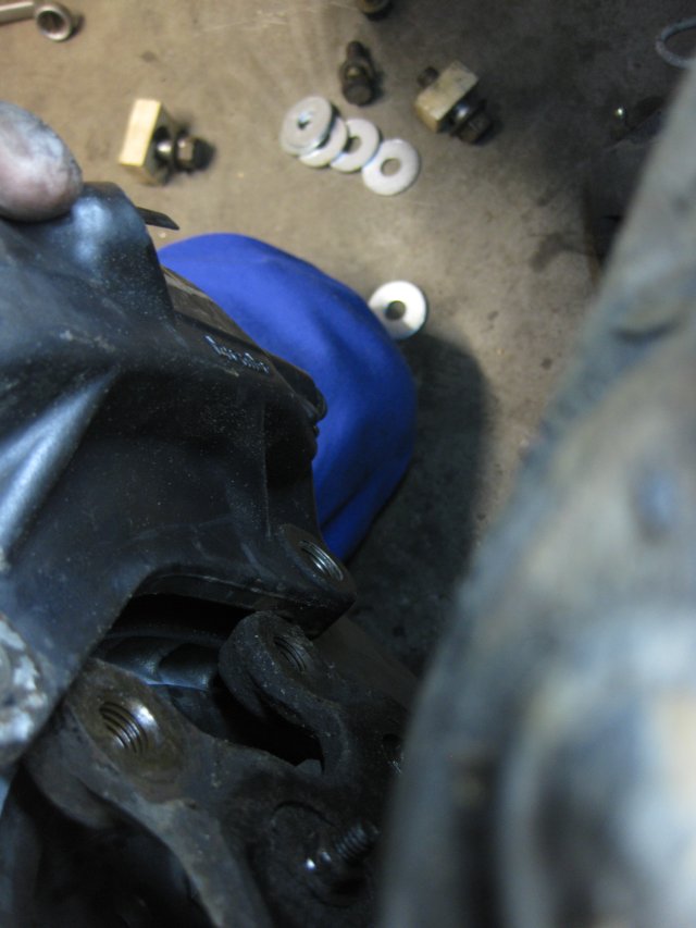

Then here is the issue. The caliper cannot slide enough towards the center as its mounting points touching the upright ears. There is about 15mm, I would need to further push the caliper for full brake pad/disk touch.
Need to slide in about 15mm.jpg (71.42 KiB) Viewed 10552 times

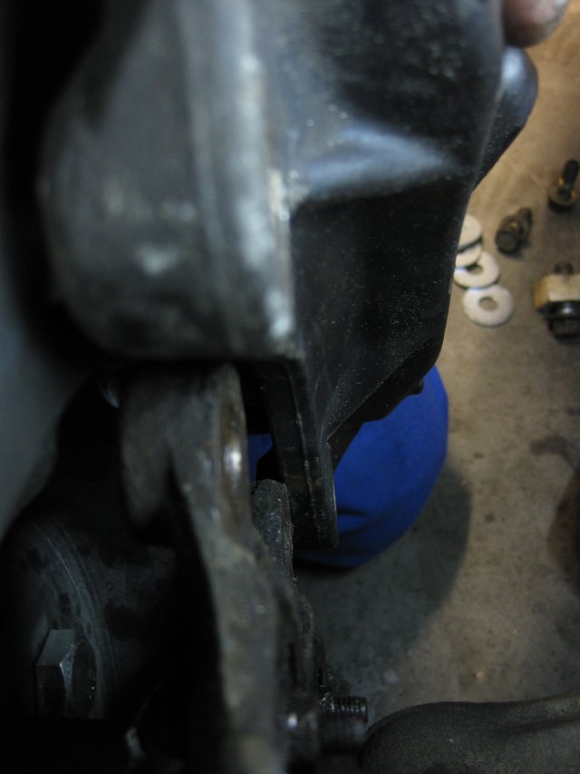

The upright ears are blocking the caliper. There are about 1-1.5mm overlap in between the two parts.
Need to overlap the caliper and ears 1.jpg (59.76 KiB) Viewed 10554 times
Need to overlap the caliper and ears 2.jpg (68.37 KiB) Viewed 10554 times

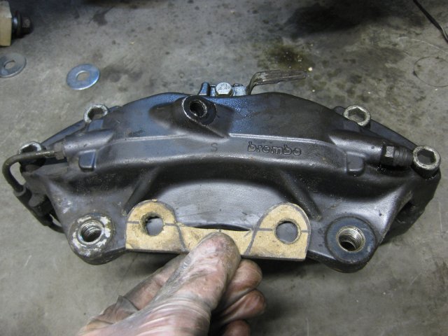

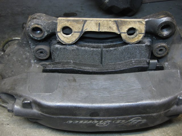

So the question is:

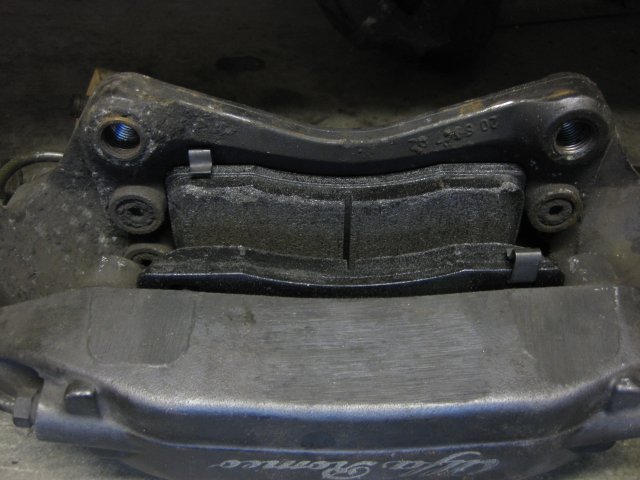

Can I shave off this about 1-1.5mm from the inner side of the caliper in between its 2 mounting points? I probably need to take the material out only in a shape of the upright ears. Or would it weaken out the caliper too much?
Few pictures to illustrate what I'm asking...
Caliper and its mounting points:
Alfa166 Brembo caliper.jpg (57.66 KiB) Viewed 10547 times
This is the rough mockup for the ears, I need to shave off the 1.5 mm thickness in this shape.
Alfa166 Brembo caliper with ears mockup 1.jpg (71.21 KiB) Viewed 10547 times
Showing it on the outside of the caliper too:
Alfa166 Brembo caliper with ears mockup 2.jpg (68.12 KiB) Viewed 10550 times
OR
Would you guys suggest to go for the option Kevin chose. Cut off the ears from the upright, and drill new holes closer to the ears' neck, so there wouldn't be any modification needed on the calipers.
Cheers

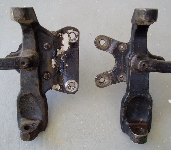

Re: Some more brake upgrades for the 116-Barry
Here's the solution I used for a similar problem, in order to mount Lancia Integrale Evo calipers on the previous 3liter car. Whatever weight was added to the uprights was offset by these calipers -much lighter than Brembo red 4-pots!
JK
I can't make that out clearly. Is that conversion plate held on by 2 M6 bolts or is it welded onto the upright?
Tx
Its all welded up and then machined. The 3 M6 bolts are for the seal shroud and (what's left of) the stone guard plate. The plate was cut off after the discs warped after every trackday...took a while to figure out the lack of even cooling (because of the plate) caused distortion and subsequent brake judder! After the operation, problem solved. :roll:
