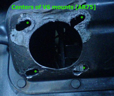

I know that they are different - at least on AR 75.
Check this picture below: I tried to fit TS booster on V6 pedal box and with all drilling I couldn't do it, so I took TS pedal box and changed order of plastic spacers between brake and gas pedals.

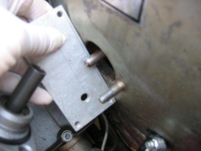

I am using Bm boosters on two of my GTV's . The one works great BUT the other cannot be adjusted(threaded shaft behind runs out of thread) to make the pin potrude far enough out when you press the peddle. Thus you can never bleed the front brakes proprly as the piston does not get pushed in far enough. Using the standard alfa mastercylinder the pin needs to push out +- 23mm. Here is a pic of this booster which only comes out 13mm.
You cant just add spacers down the master cylinder to tube to build up the difference otherwise your brakes start to bind after 20 mins of driving. If you look at the pedal assembly behind booster its on a cam angle so your adjustment must be perfect. This is just something to check when changing boosters.
For me the best booster on the 24v conversion with most space is the Giulietta booster.
Check pic
Re: Brake Booster? Anything that can replace it?
Kevin,
Why havent you just fabricated a push rod of the correct length. Am I missing something here?
MD , i will get this booster to work but I need to get a die to cut a thread of another 10mm on the back and then get a similialr or same end piece(part the pin goes through with split pin) as the GTV or Giulietta. It will then work . Just had spare Giulietta boosters lying around and was much easier.
