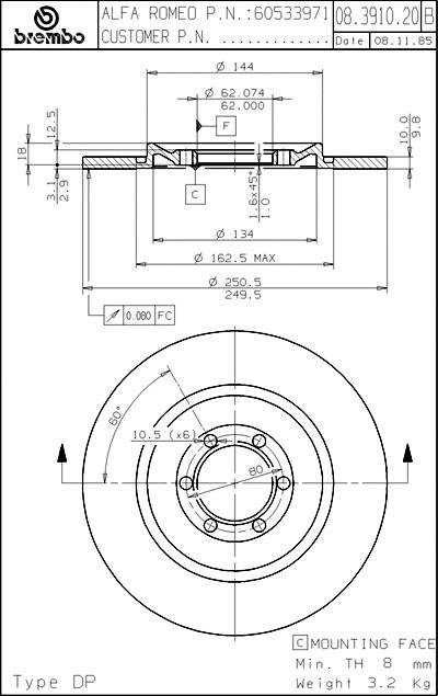

Edit: The peug 306 (dia 265.5 mm) looks like an upgrade from the 309....
75 backside
75 backside
peugot 309 front
peugot 309 front

the smallest UL-HP : dia 10.50" (266,7 mm) x width 1.15" (29,2 mm) would work, or am I missing something here?
Nope. I'm blind.
That would be perfect. Lets google evilbay for a price.
