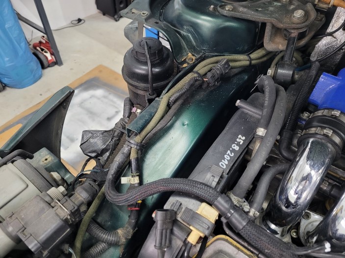

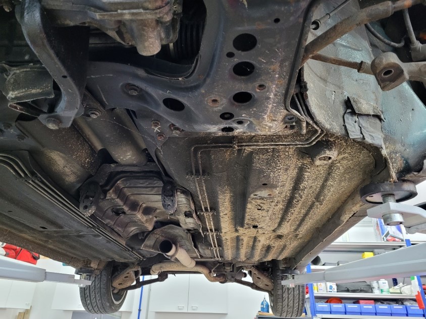

Re: Alfa GTV 916 2,0 V6 TB bring back to life after 12 years
Hello Zamani, nice hearing from your side, that you love my project.
During main assembly there is not that much to write, exept there were a lot of damaging because car was only standing without moving ...
Just a small list:
timing belt (last change 25.08.2010 !!!)
wheel bearings
shock absorbers
all brakes
clutch cylinders
brake main cylinder
all sealing rings
fuel pump
all rubber parts arround fuel pump were like silicone and glueing everywhere, also in the tank (was almost empty)
etc, ...
Here are some pictures how I got the car (delivered on a trailer) and the start of disassembling and working on some parts to prepare.
Just a small list:
wheel bearings
shock absorbers
all brakes
clutch cylinders
brake main cylinder
all sealing rings
fuel pump
etc, ...

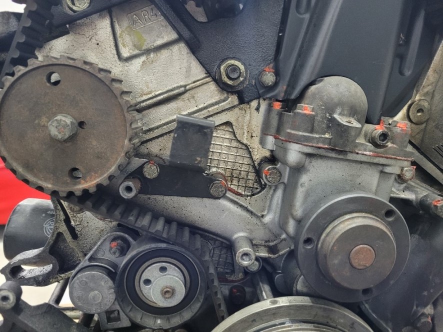

It is to say, that the car had already a very old aftermarket HALTECH E6S on board, so more complicated to find correct drawings of harness and pin out diagrams of ECU (Thank´s to Haltech download center special for old ECU´s and parts.
One of problem was, that there was not a 60-2 tooth supply on crank pully so I had to find a good used one ore take off the Haltech disc where some magnetics north and south pole were glued in. Also I have to change crank sensor, because Haltech sensor works only with that ECU.
At least I could solve all that problems !
During disassembling I´ve found out that on Cyl. 4 exhaust side there was broken one stud for exhaust manifold. It´s always tricky to get out that broken things ...
Look at picture no. 40 .......
My friend was lucky that there was no problem ... shim oil pump gear was almost gone, have found all pieces in oil sump-
