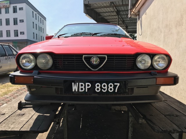

Guys,
Attached are some of the final results from my dad's 1984 GTV6 3.0. It was originally a GTV6 2.5 which my mom used. But she graduated to a 156 GTA and now looking into a Giulia QV. But my dad always loved this car. The engine sound was different compared to the Nord Alfas he used to own (Giulia Ti, Berlina 1750, Alfetta, Giulietta) and an Alfasud 1.2.
I'll add more comments later but I'm going to post some of the photos for now.

Which car did you source 3.0 from ? Car looks very nice with clean lines.

This was a 75 3.0 engine. EFI was from a 164 12V.
