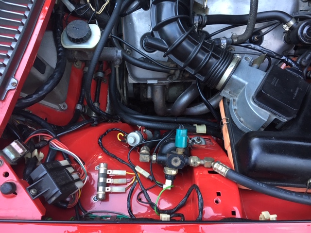

On taking possession I spent the weekend removing seats and door panels to deep clean the carpets, vacuum out the doors of grit , replastic and spray rust inhibitor . Still had few hours so while cleaning up engine bay I removed radiator to flush out. I just wanted to make sure car was ready for all the driving I'm going to do while finishing of the project cars ( spider and Junior ) . This is all probably over the top but sometimes you cant help yourself ;)

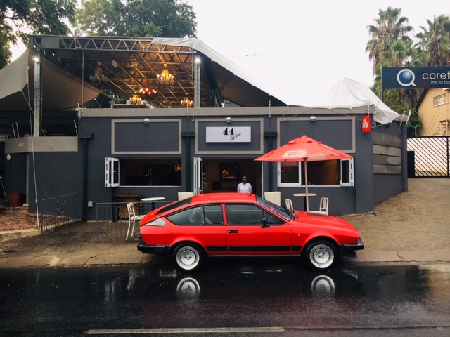

I collected the car from Dawie DeVilliers at Zwartkops . Pic of Dawie next to the car .

The engine bay starting to look really good now and time to get on the road to see what this car is all about !

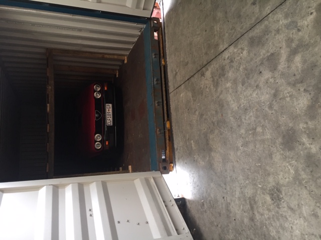

Pic GTV going into container at Limbro Park . Johannesburg. I always like to load my cars personally . Just sleep better :)

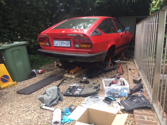

Work started very promptly last month jacking up the car on a slope with correct support work under all the axle stands. I thought if I'm lying under there striping entire suspension, pressure cleaning , scraping and painting then this car must be safe and higher enough up to work . I used two jacks ensure safe rigging !

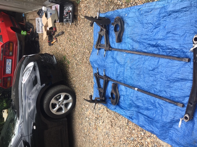

One heavy weekend and all the suspension is out . I guess it would have been a lot quicker if the car was in my store and easier work surface but there are no barbie facilities ( Braai ) and cold fridge !

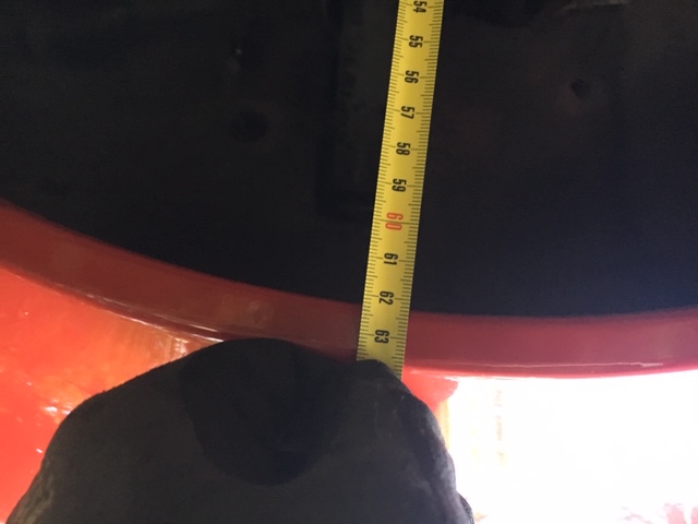

I like the original ride height so I made marks on the torsion bars back and front with reference to the factory slots. I also took measurements from the lower control arm to the wheel arch just incase I loose my notes.

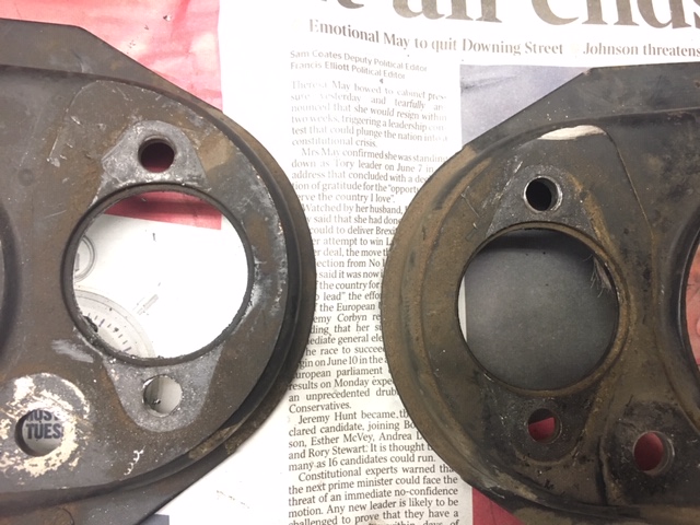

The beauty of dry climate cars is that none of nuts and bolts are rusted on so stripping down is pretty easy. You can see the condition of the body work is good by the seams in the arches but the under seal that was sprayed over the body colour has got hard over the years . Some areas where it' has shrinkage cracks in the underseal it is a must to wire brush down so no salts or moisture can get into those cracks. This was my next step after I stripped down all the suspension and pressed all the bushes out.

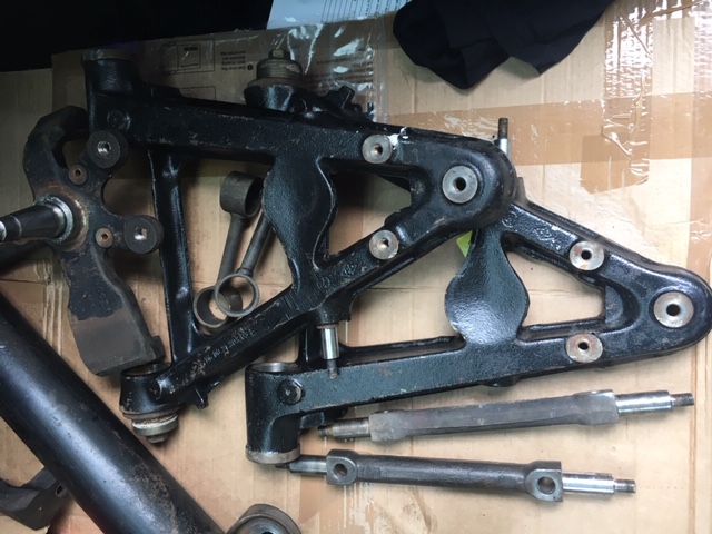

I started stripping out the upper arms first. You have to grind the pressed rivets flush then drill them out making sure you have punched them dead centre first. The inner arm bush I just drilled loads of holes around the centre and then pressed it out with a socket. These came out really easy. The condition was OK of the bush but loads of play in ball joints. So this area will definitely be improved upon.

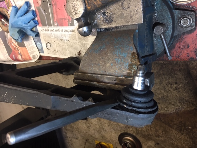

The lower arms are always a tough job even with the correct tool to remove the inner bushes. It's not advisable to try pull both bushes at the same time as you will strip the threads . Plan is to loosen the nut off on the opposite end of the locking caps. This means you pull the closest one out first.
The outer ball joint is removed by use of simple chisel. I'm not sure what Alfa suggested but this seems the only way !
The cross member bushes seemed pretty good but they must go as well . Can't have these in when there off to the powder Coaters.
Special thanks to Alex for allowing me acces to his tools to strip down these arms .

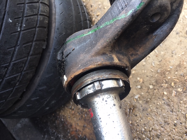

With a few more hours left of the weekend I decided to try strip down the dedion. Even with a rattle gun the lock nut was not coming loose. There goes my theory on dry climate cars ! A one metre lever bar and tapping shock waves into the bearing the nut came loose. The hubs were also very tight and could not be tapped out with a copper hammer with distorting the metal so borrowing a hydraulic puller proved the solution. As I was going to use a poly bush in the centre of the dedion I decided to grind the tabs that hold the locking washer out now so no powder coating would be damaged .

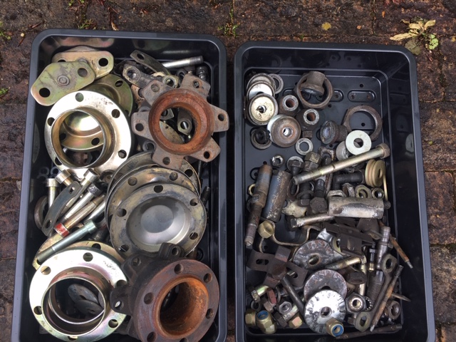

Finally all the parts off to the platers and powder coaters. This should take a few days as its been pre booked . The condition of the parts is really good so the quality once the items have been coated should be dead smooth. The nuts and bolts going off to the platers was split into the front of car and rear. This should make it easier to sort once every thing is back. It's worth telling the platers if any items are cast iron as they go through a few more processes of pickling first to get a good finish .
