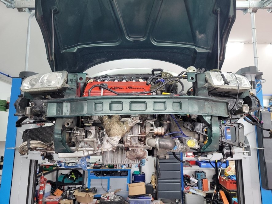

more pics, ...
pic 68_24.jpg ... MARRIAGE !!!

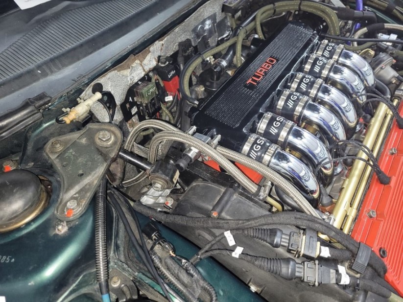

more pics, ...
pic 68_27.jpg ... solenoid for electronic boos control via potentiometer located in middle console.
Poti will give a signal to ECU, so it knows how much boost and then via MAP Sensor and WIDE BAND LAMBDA adjustment of injection and ignition.
pic 68_29.jpg ... had to make an adapter for fuel pressure sensor on lath ou of a squared aircraft aluminium bar.
