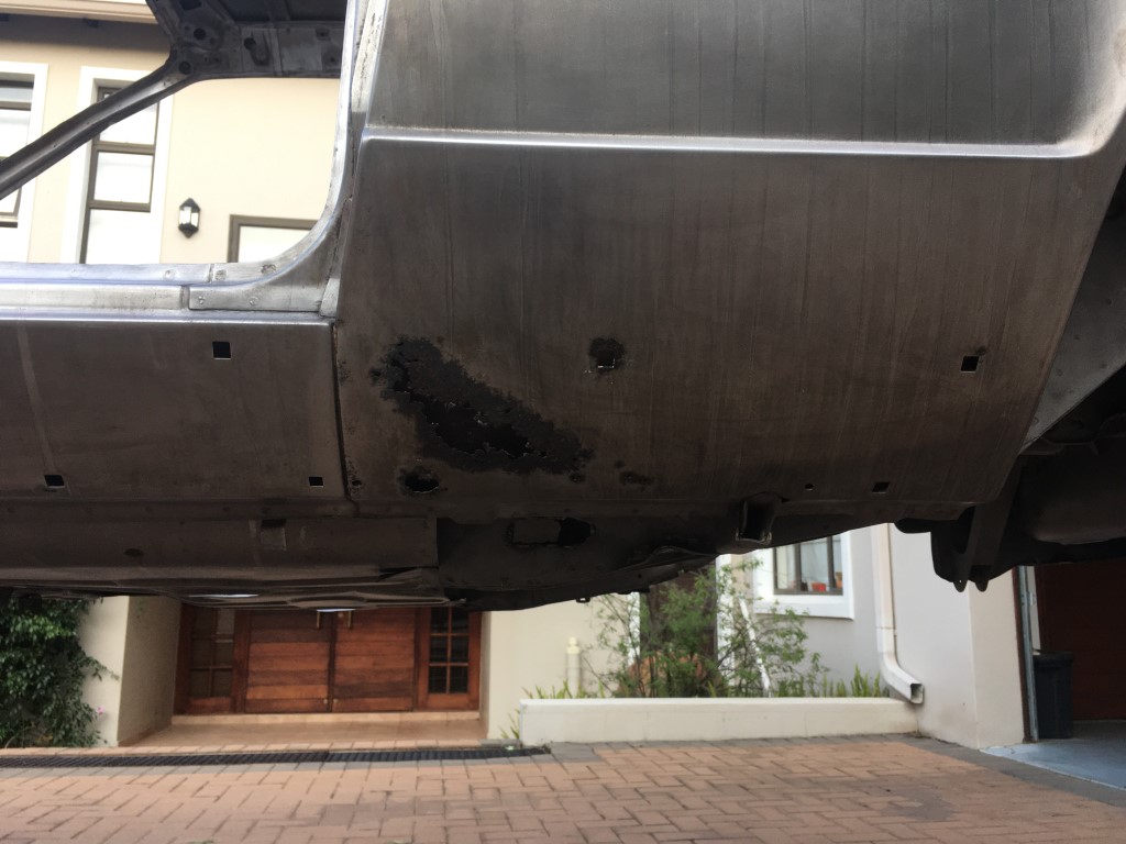

Highlighting some of the USUAL culprit spots where rust damage was quite severe and the panels would have to be replaced or repaired
Front left behind the wheel arch
Back left before the rear wheel arch
Left rear sill under the tail lights
Front right behind the wheel arch
The usual front window sill on the right hand side

This definitely has to be the most extreme restoration done by the owner on this forum. How long did it take you to take all the paint off ? Those rust spots are typical of SA cars, the usual high dust content from all the mines, farming etc finds itself into the cavities in the sills and blocks them. Leave this saturated and blocked for 25 plus years it will corrode. Those areas around the windscreen seem to be poor paint protection as you see when you take the windscreens out their is only primer in places.
I have seen the guys using flexible windscreen sealant between the glass and rubber to stop the water ingress but not between the rubber and steel frame. The rear valance corrodes from the bad seal on the tailights then the water gets under the seam sealer between the boot floor and rear valance. This i only see on SÅ cars. You need to rake all that seam sealer out. I added small drain hole but was small enough under carpet not to get exhaust gases in. New foam seals around tailights help problem.

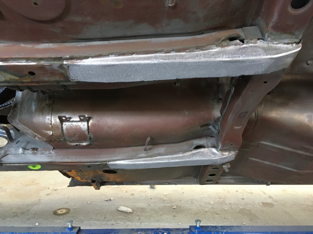

REPAIR WORK AT THE SHOP
The pictures in the posts that follow were from many weeks of viewing the car as progress was made. I tried to get there are least once a week to check on progress and take pictures.
Repairs to the window sill, you can see original condition in earlier posts
Repairs to the arch on front left side. You will see that flash rust started appearing and this prompted them to prime the car earlier before repairs were completed and then continue piecemeal.

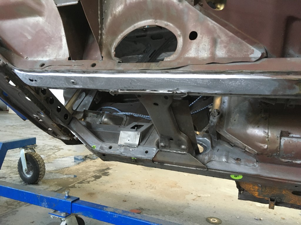

Underneath of the front of the car "skids" (not sure what these are called?? :lol: ) repaired well with steel and lead.
Green stickers with catalogue key number visible in places

Coming on nicely. The usual rust spots on the GTV6 except the one under the left rear tail light is common to SA cars as the factory put seam sealer between the rear valence and boot floor behind the battery well. When the taillights leaked water from perished seals it just got trapped and found its way under it. I was looking at a left hand drive GTV shell a few days ago and zero rust there . Don't forget to put drain holes and inject cavity protection ( not wax) into the chassis rails under neath that you replaced. Good thing is SA cars don't rot from inside out in all the other areas like the UK cars from the cold, damp and salty roads and a bonus their is no sunroof ( all uk cars fitted) to start another rust factory. I'm still not sure why they fitted sunroofs in uk cars as this lowered roof height by an inch with an already lmted head room on standard seats combined with two long raking glass screens . Today there are no spares for the sunroofs and you would be lucky they don't scratch the paint when opening them.

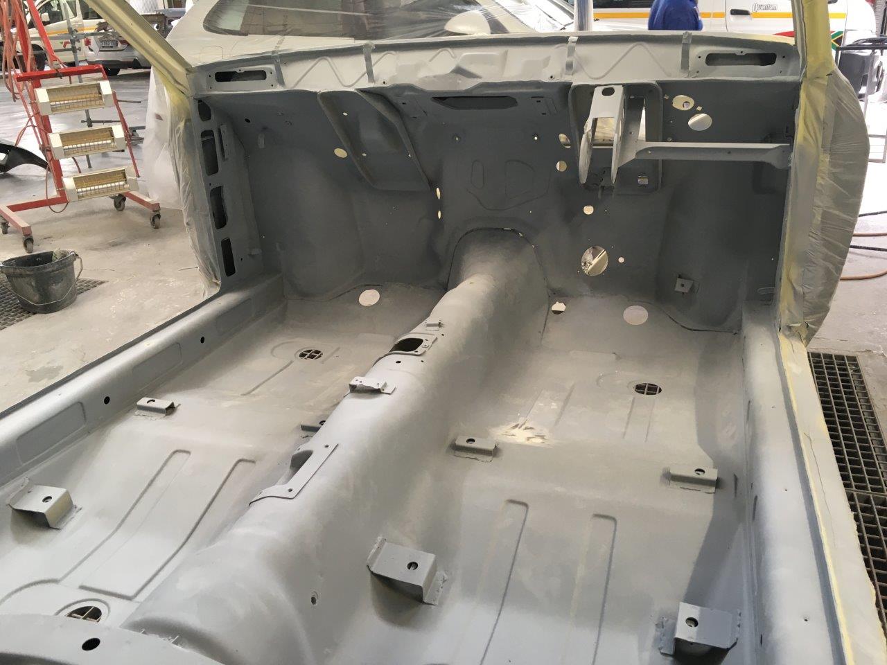

RESPRAY
After Rapid motors has effected the metal repair work, they started on the spraying.
I had left my rotisserie with them - this assisted a lot in moving the car around and minimizing handling damage.
They initially did a primer whilst they were still doing final repairs. Then Sikaflex all the panel joins in the car. The whole car then received a black light coat - this apparently allows seeing any imperfections in the bodywork.
Finally another primer, then into the spray booth.
Some pics of the ancillary bits and pieces included.
Then back home on a trailer with no wheels!!
I picked up a few blemish areas so the car had to go back again for some touch ups, and then once again back home - this time with wheels.
