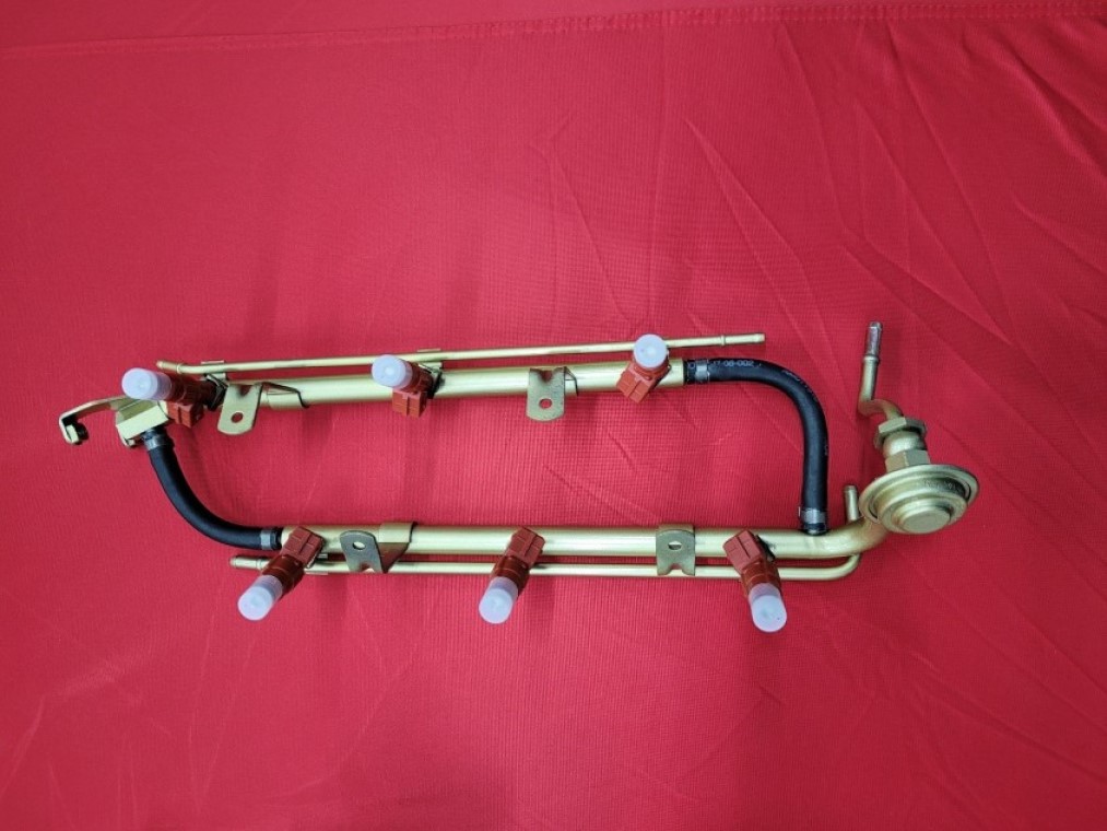

Re: Alfa GTV 916 2,0 V6 TB bring back to life after 12 years
more pics ...
on pic 59_1 you can see finished fuel rail with big injectors (320ccm), they are BOSCH 0 280 155 759
- Picture 57_1 Valve Covers+Air Intake.jpg (203.12 KiB) Viewed 10892 times
- Picture 58.jpg (143.95 KiB) Viewed 10892 times
- Picture 59.jpg (148.52 KiB) Viewed 10892 times
- Picture 59_1 Fuel Rail ready.jpg (128.58 KiB) Viewed 10892 times

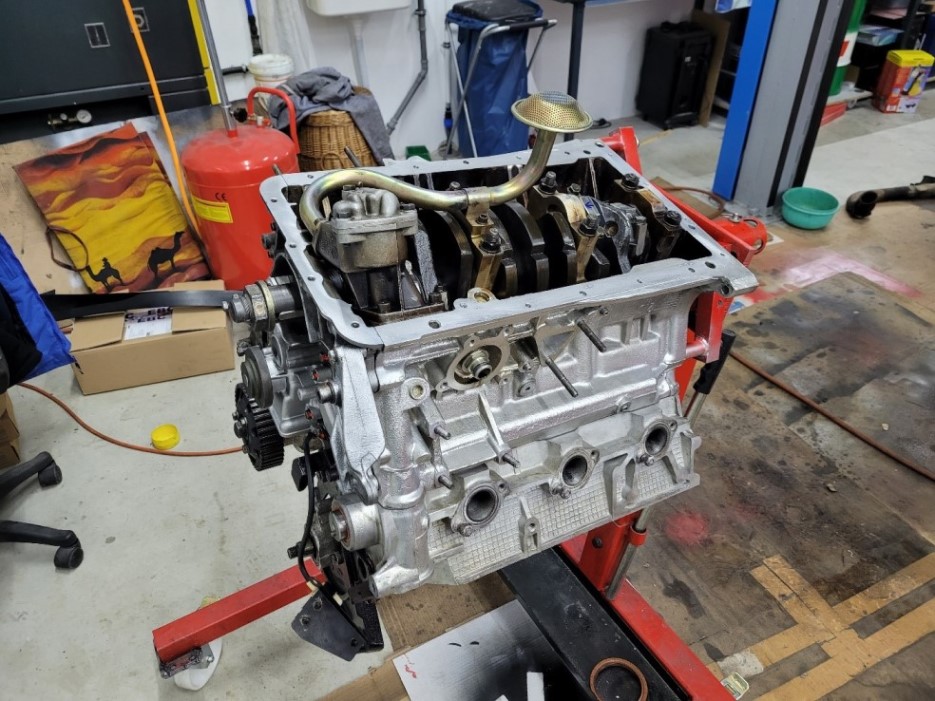

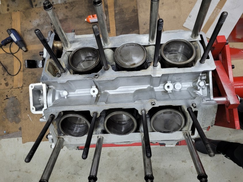

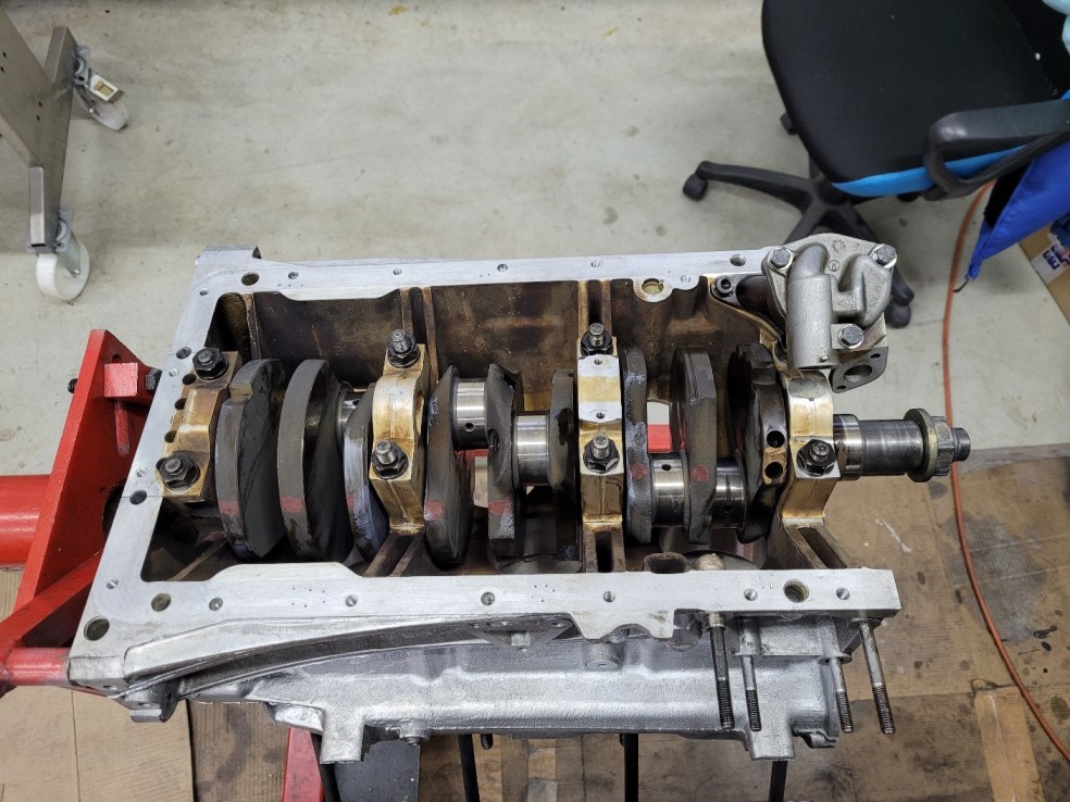

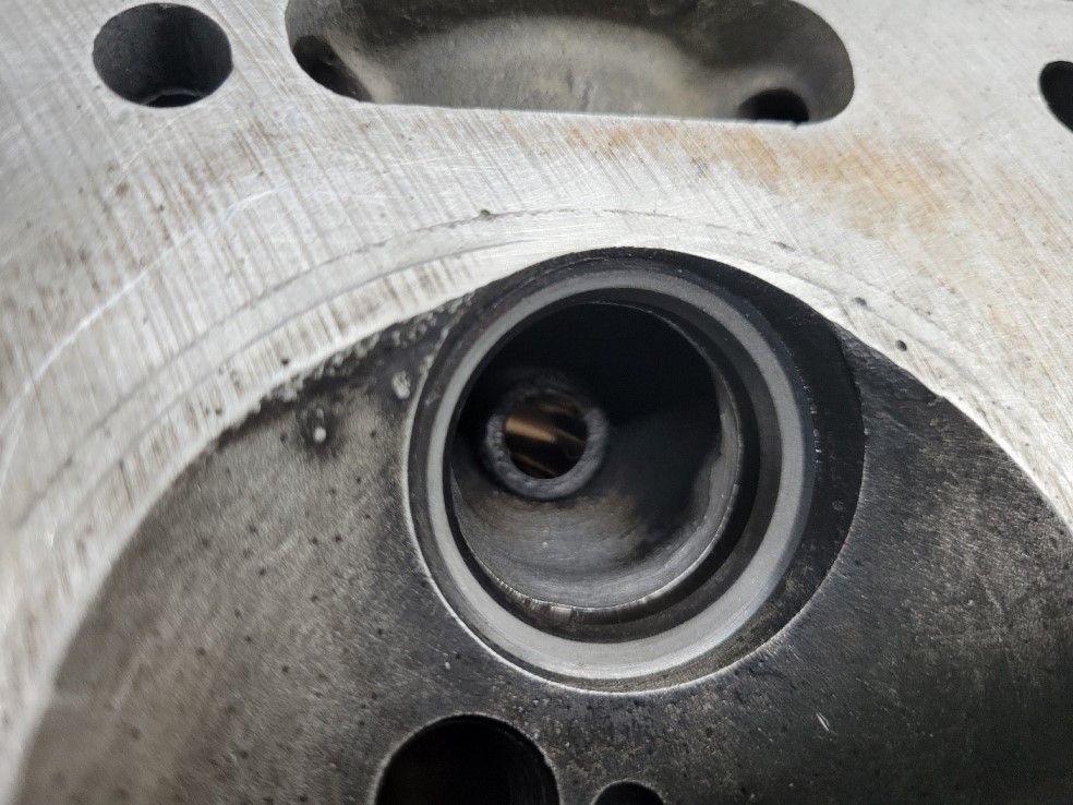

more pics as I´ve promised ...
On pic 61.jpg you can see exactly one of worn exhaust tapets, surface lookes really bad.
Pic 64.jpg: starting assembly with crankshaft, of course with measured new main bearings, STD size was fine.
- Picture 60.jpg (133.63 KiB) Viewed 10865 times
- Picture 61.jpg (159.27 KiB) Viewed 10865 times
- Picture 62 Valves grinded in.jpg (154.15 KiB) Viewed 10865 times
- Picture 63 Valves grinded in.jpg (174.17 KiB) Viewed 10865 times
- Picture 64.jpg (185.64 KiB) Viewed 10865 times
Last edited by Alfa 75 Racer on Sun May 15, 2022 10:54 pm, edited 1 time in total.

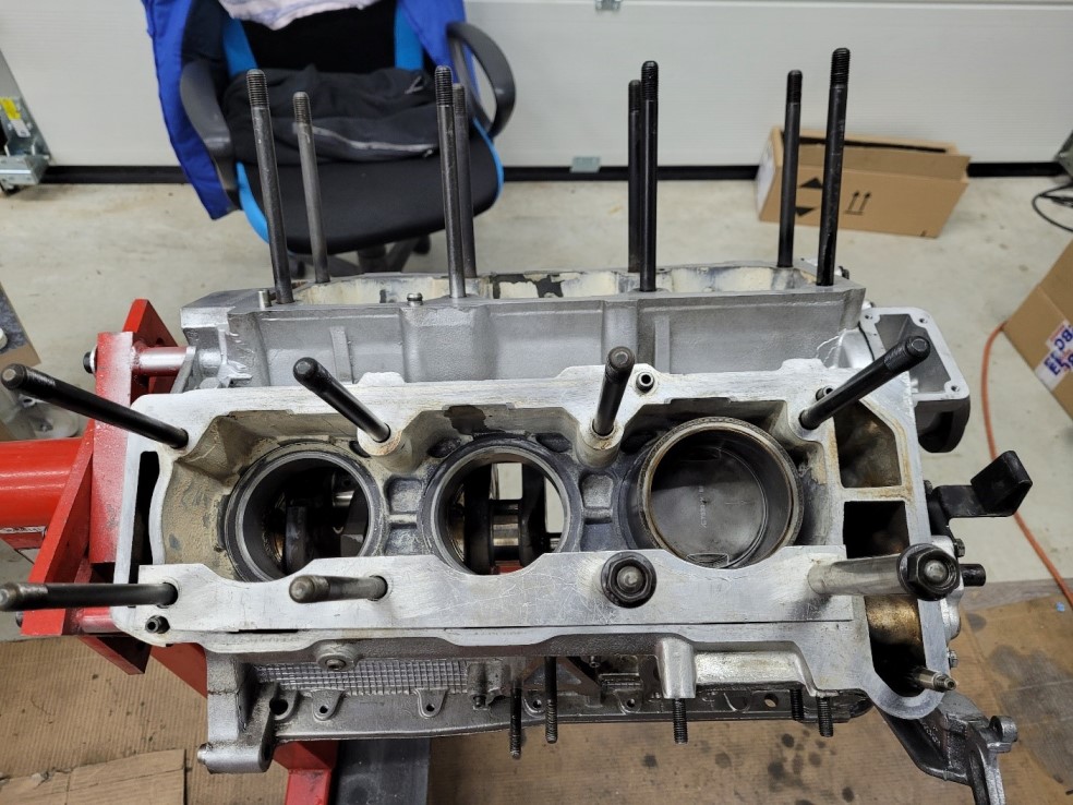

more pics
starting with real assembly.
On the 2,0 V6 Turbo it is not possible to put in first all liners and then install pistons, because rod eyes were to big for bore of liners.
So you have to assembly piston with liner first and then install assembly in block.
- Picture 65.jpg (186.47 KiB) Viewed 10865 times
- Picture 68_assembling_1.jpg (181.59 KiB) Viewed 10865 times
- Picture 68_assembling_2.jpg (152.68 KiB) Viewed 10865 times
- Picture 68_assembling_3.jpg (208.91 KiB) Viewed 10865 times
- Picture 68_assembling_4.jpg (178.81 KiB) Viewed 10865 times

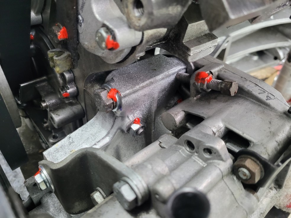

more pics, ...
pic 68_7.jpg, machined inlet flanshes a little bit so they will fit without any edges to heads
- Picture 68_assembling_5.jpg (175.88 KiB) Viewed 10863 times
- Picture 68_assembling_6.jpg (155.59 KiB) Viewed 10863 times
- Picture 68_assembling_7.jpg (184.73 KiB) Viewed 10863 times
- Picture 68_assembling_8.jpg (164.63 KiB) Viewed 10863 times
- Picture 68_assembling_9.jpg (205.6 KiB) Viewed 10863 times

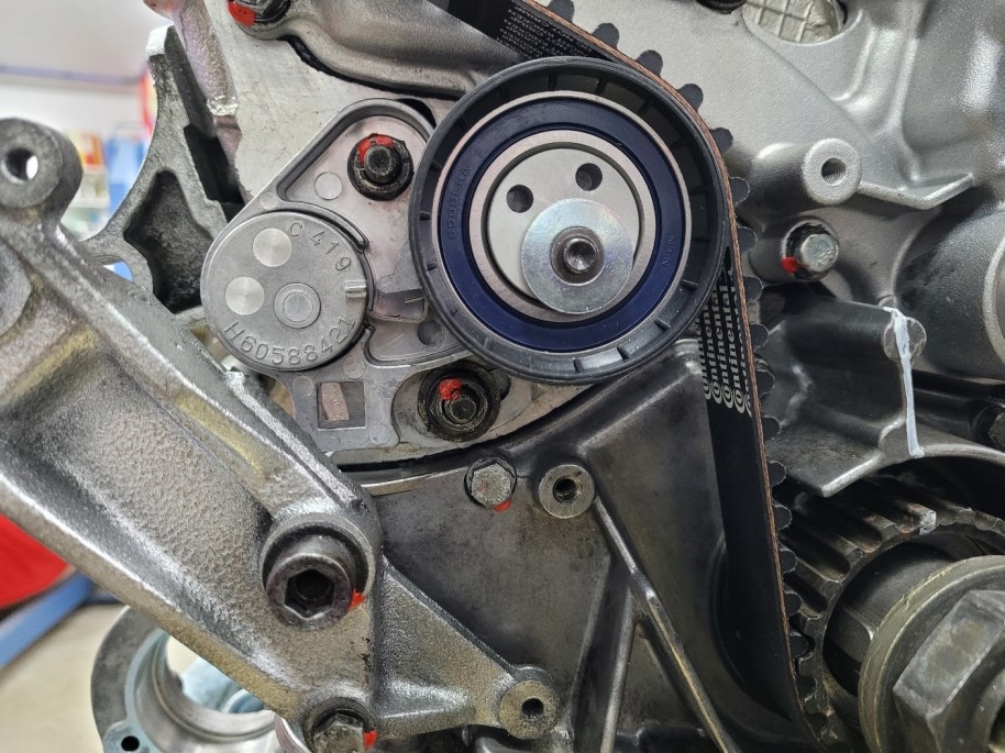

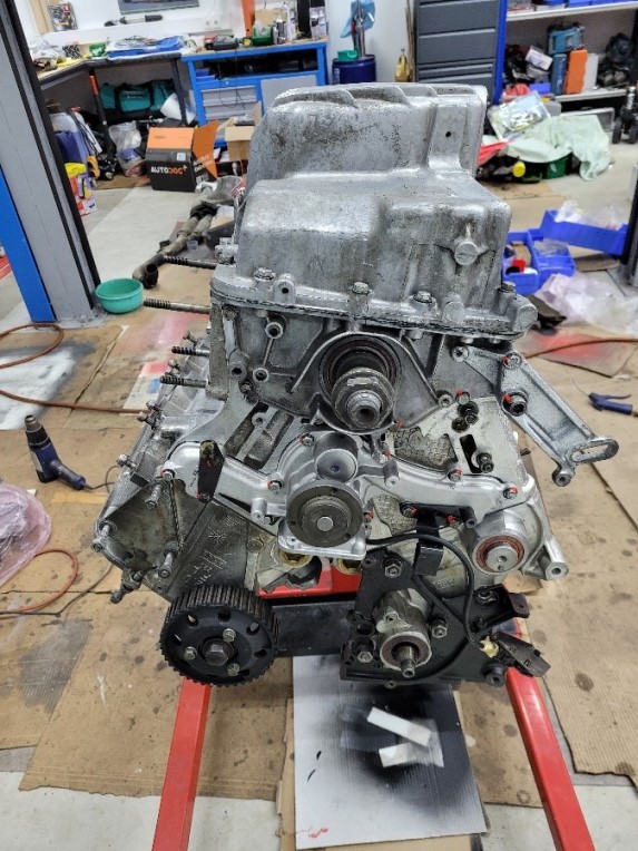

more pics, ...
mounting of timing belt, tensioner.
ATTENTION: there are two different types of timing belts, old 164 2,0 V6 Turbo will need timing belts with sharp edge profiles !
GTV 916, 164 2,0 V6 Turbo SUPER and 166 2,0 V6 Turbo will need rounded profile of teeth. (CONTITECH CT819)
141 teeth.
Exact check with dial gauge and check positions of cams, there is no adjustment possible on cams, of course you can mashine pullys, every time there is a way, but normaly position marks of 2,0 V6 Turbo engines are good.
I´ve tryed just for my interest to install a sharp edge timing belt on a GTV 2,0 V6 Turbo, ... yes it will fit, but there is a little space on each tooth when you are looking through and at the end, position marks on cams were not fit 100%.
141 teeth.
- Picture 68_assembling_10.jpg (184.56 KiB) Viewed 10861 times
- Picture 68_assembling_11.jpg (202.14 KiB) Viewed 10861 times
- Picture 68_assembling_12.jpg (199.96 KiB) Viewed 10861 times
- Picture 68_assembling_13.jpg (191.1 KiB) Viewed 10861 times
- Picture 68_assembling_13_1.jpg (172.14 KiB) Viewed 10861 times

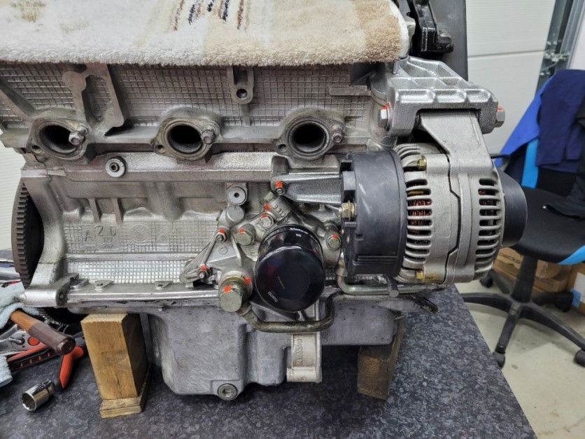

more pics,...
pic 68_14 you can see new servo pump instead of clima compressor installed.
pic 68_16 for new oil temperature display, I had to make an adapter on the lath.
Clutch is a special one, it´s a Sinter Metal with torsions springs to handle that hopefully coming high output power.
I know that power will come because in my old 164 V6 Turbo I had with same Turbo and Boost of 1,7 bar a power output of 315 Horse Power on dynamo.
- Picture 68_assembling_14.jpg (167.31 KiB) Viewed 10860 times
- Picture 68_assembling_15.jpg (154.49 KiB) Viewed 10860 times
- Picture 68_assembling_16.jpg (190.32 KiB) Viewed 10860 times
