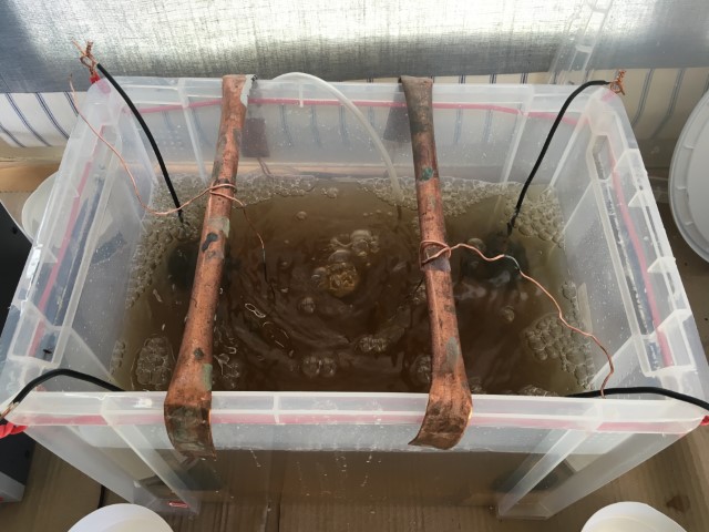

Early on in the project, I made the decision to set myself up to do my own electroplating.
Bought a kit from Tshwane Plating (Dean Boniface).
This is a very time-consuming but satisfying process.
I struggled with getting it right at times, and had to redo some items.
The process:
The power supply (bought from DIY electronics in South Africa) You then need a tank to put the plating liquid into (comes premixed in 5l containers from Tshwane Plating).
I would this from PlasticLand and it holds 15l comfortably, a reasonable size for most plating of smaller parts
The wiring I added to make it as easy as possible to setup and take apart. Less, use BIG zinc annodes, the bigger the better for your tank. When I used smaller ones, plating larger parts was a problem.
The process:

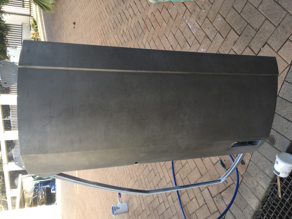

CLEANING THE PARTS
All the pars were taken down to their smallest components and then cleaned.
I have a sandblasting cabinet and for the most time have been using aluminium Oxide "powder" to do the cleaning. It lasts and can be re-used, and is non-toxic.
Here are some items before and after sandblasting.

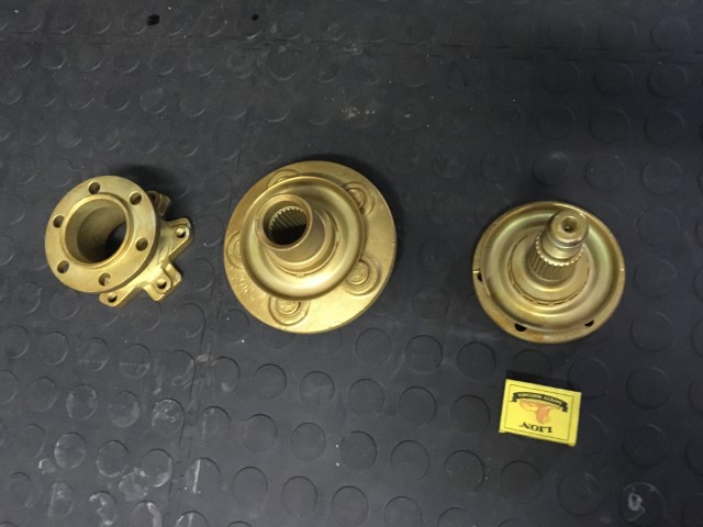

You adjust amperage UP when doing larger parts. Smaller parts you can apply 2-3amps and keep in tank for 25-30 minutes. When the pieces come out, they are ZINC plated and bright shiny silver. You could use them like that.
Next step is to dip in a pickling solution. I have been using diluted (5%) Hydrochloric acid. This chemically cleans the parts before plating.
Do not leave in for too loong as it can then blacken the metal and you have to clean it again! Thereafter hang onto the copper strips on the tank.

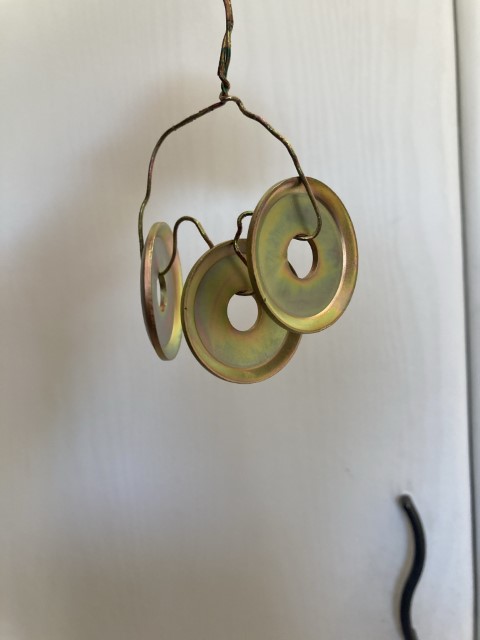

Importantly, between each step, you must rinse the parts in CLEAN water very well!
After plating, I dip the items into a Yellow Passivate, which has a chemical reaction with the Zinc and creates an even more anti-corrosive finish that also has a translucent gold colour. Some examples of finished items, I am sure you can figure out where they all go!

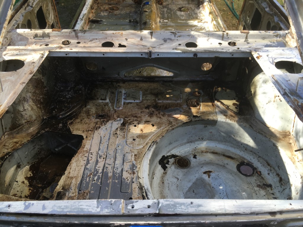

STRIPPING OF CHASSIS
I elected to strip the chassis at home, to make sure that a thorough job was done and all issues on the car identified. I researched different options and finally elected to give Hydroblasting a try. This is using high pressure water with glass beads. I was advised not to try dry blasting as it build up lots of heat and can warp the panels.
The Glass beads used The Karcher blasting attachment, used together with my Karcher high pressure cleaner Stripping process starts - fortunate enough to buy a Car Rotisserie, this makes life so much easier to move the car around and to get to awkward places Converted my car port into a blasting shed Engine bay BEFORE
