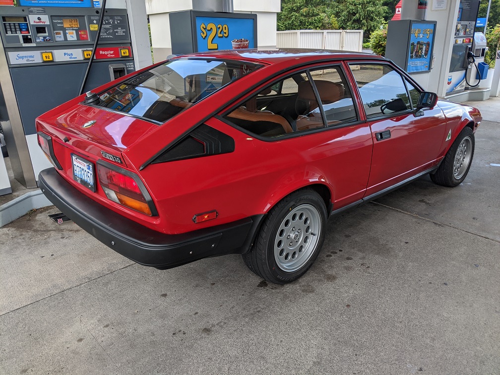

So its been 20 months of gradual progress but the car is finally driving again! I feel like almost everything I encountered was broken in some way so progress was slow. On the bright side, almost everything has been overhauled or replaced and I feel like the car will be reliable. It has a 3 liter engine I built in 1998 with S cams and CSC headers so it goes nicely! I'm currently using the original 1981 Bosch ignition system but the fuel ECU has been replaced by a modified 3.0 Milano unit. I'm already planning Megasquirt and the engine has a 164 pulley and wheel and timing sensor. I installed a wide band O2 sensor and I see 13.9 AFR at WOT and I think the car would make better power in the 12.9 - 13.0 AFR range.
Lets see, it has replica Ronal wheels, and Euro type bumpers I bought from Alfa Panels in the UK. Actually, the front bumper is not yet fitted because my car needs some body work to straighten it out before the bumper will fit properly. Now that its on the road, I'll be able to take it to various body shops to see if they can help. This is my one disappointment with the car; I really wanted one with a straight body and this one was represented to me as being cosmetically great but its obviously been hit in the front and the driver side wheel arch is damaged (& poorly repaired) and the front is pushed slightly in. I think its repairable but beyond my skill level so its going to be expensive.
I also found an Alpine stereo which seems period correct and I had someone plumb in a bluetooth input (using the old AM band). It awesome. I kinda like the seats though the Recaro Specialist seats are tempting me.

Thanks Kevin! Also for the ideas on mounting fiberglass bumpers. My idea is not quite as neat, I do have some mounting bolts showing.
I painted the bumpers black just for fun, and I think I like it a bit better than the red bumpers, mostly because the trim behind the bumpers is still black.

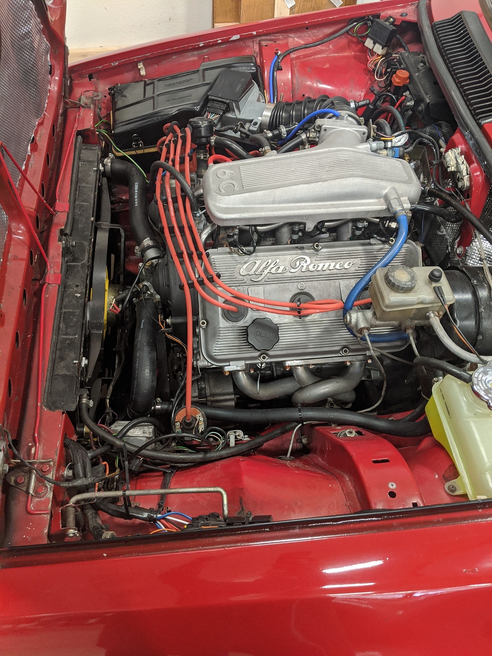

I have spent lots of time on my engine management recently.
To make sure the engine was running well, I installed an Innovate wideband Air/fuel ratio gauge and determined that my car was running lean at WOT - AFR somewhere near 13.9. To correct this I contacted Al Mitchel (on the AlfaBB) and he made me a 'plug-and-play' Megasquirt solution. It consists of a gutted L-Jet ECU with a Microsquirt module installed inside, a MAP sensor, an IAT sensor, a Bosch TPS, set of 6 High Z fuel injectors on a GTV6 fuel rail and a small wiring harness needed to make everything work. The ECU plugs into the stock Bosch connector so it can be reversed easily.
I have an early car so I had to add a couple of pins to the ECU plug but it was easy. I'm using TunerStudio currently to dial in the MAP - its really nice software! I'm running stock ignition for now. Best part about it is being able to remove the factory AFM. Next job is to relocate the cone filter behind the headlights since its something of a 'hot-air intake system' right now.
My car has a 3.0 liter Verde engine, 164S cams with a Sperry Stage 1 valve job (Anyone remember those guys?), CSC headers. Contact me if anyone wants the .MSQ file reflecting current state of tune. The car feels faster and definitely has smoothed out the running. I'm also ready for new modifications if I ever decide to go with higher compression pistons or aftermarket cams.
Al has really done a thorough job creating this kit, its truly plug-and-play and clearly a labor of love.
