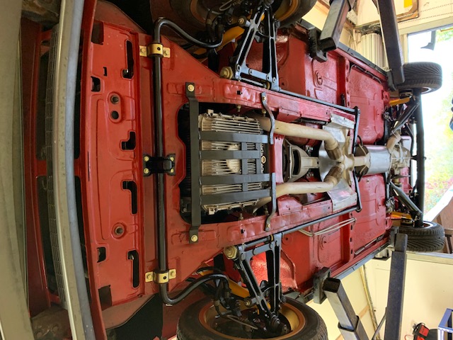

Wow Kevin, that underside is so super clean
Wish mine was like that.

Thanks guys. Really doubt it's gonna stay clean with the current weather rolling in. At least I know it's good for another twenty years.

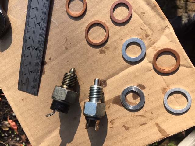

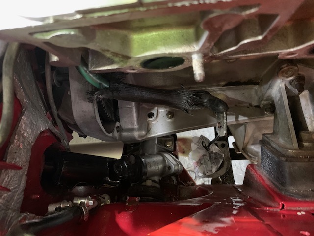

I had a small issue with the new reverse light switch staying on and after removing it and comparing it to the original switch you need to add 1mm washer extra. Believe it or not if you add another washer it won't work at all so these new switches work on a " fine " margin.

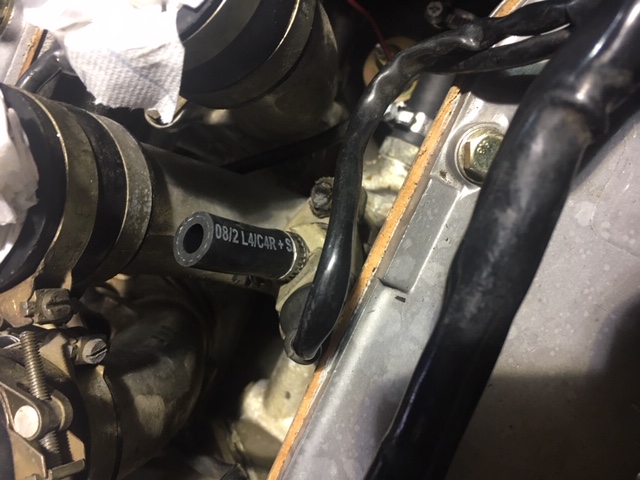

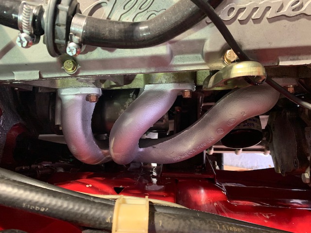

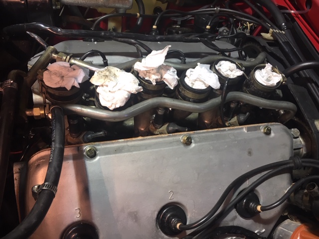

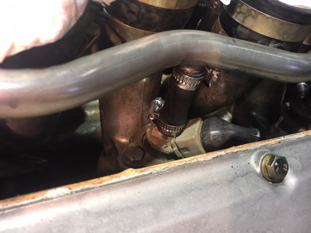

I had few hours to spare few evenings back and finally replaced last bit of fuel line on the motor. Now I can say every hose and clamp has been replaced in line with new fuel ethanol content. ( hose ) . I think I have spent over R600 on hose clamps at Wurth so far. When I'm back in SA in January I will replenish my stock. Wurth express shops make life easy to shop for wide range of items without having to buy loads of boxes.

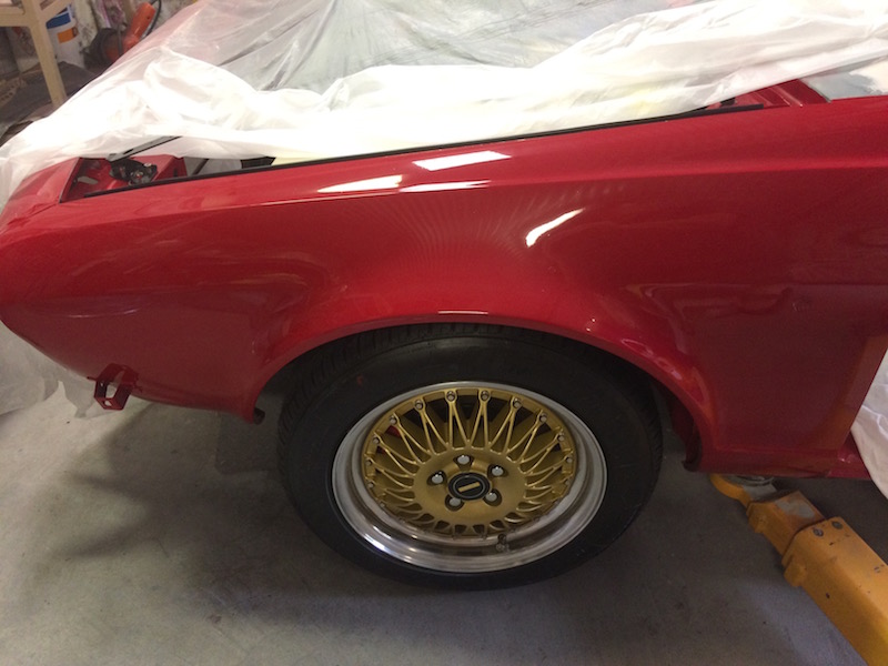

Hi Kev your GTV looks great.
I have given mine a coat of paint 130 Alfa red same as my 916 spider, Still not 100% , but no rust and starting to look great.

Paintwork looks awesome . 130 is my favourite red hence my track car and Junior is that colour.
Everyone has their opinions but it's just darker red than the original we got on our GTV6 in SA . The code for the GTV6 is 530 but that even comes in three shades. Just can't go wrong with 130

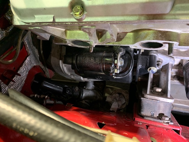

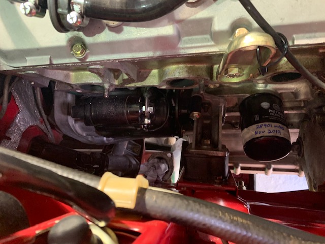

After racking up a few miles I was not totally happy with the starter motor as when the car got hot it made the usual clicking sound when turning the key so thought it's right time to do full stater motor overhaul. I gave the starter to my mate and it was the solenoid. Same time he replaced the gear as well so now it's another item fully refurbed.

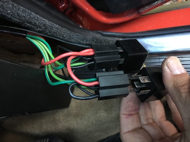

I'd appreciate it if you could post the wiring diagram for the window-motor mods with the relays. Seeing your restoration makes me feel guilty that I've not done as much to my vehicle. Fabulous result!

Firstly I am not an auto electrician but just looking around on the net and forums you can find most things. This was one of the videos but the switch in this video is earth based or activated while the GTV switch sends positive activation. So I will show in a diagram my wiring below.
https://m.youtube.com/watch?v=EYuhk7urqFE
I used two five pin type B relays for each window. The five relay has and extra pin 87a . This is like a gate pin and when it's not activated it rests in negative position. So this pin 87a on each relay is wired to each pole of the electric window. As the window reverses polarity when switched the one relay ( non activated one) will be the earth while the other relay will be switched from 87a to 87 creating a positive circuit.
So my wiring is as follows
Relay 1 ( Upwards)
86 window switch solid
85 earth
30 window motor solid
87a earth and loop to 85
87 positive 12v supply fused
Relay 2 ( downwards)
86 window switch stripe
85 earth
30 window motor stripe
87a earth and loop to 85 and loop to 85 of relay 1
87 positive 12v supply looped to 87 on relay 1
