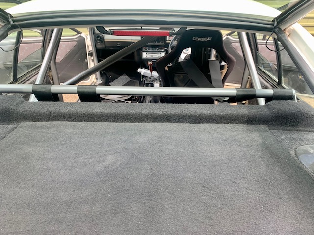

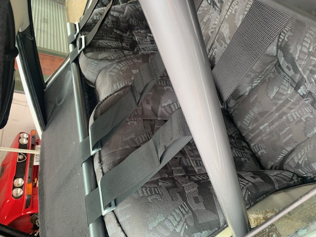

Theo and I got a few hours in to fit the rear seat belt bar, seat belts and seats. As the Safety Devices roll cage is a basic it dose not have any seat belt bars. Following the MSA rules on seat belt angles the shoulder belts must be with 15 degrees of shoulder strap holes in seats. Good thing the GTV has already four chassis mounting holes under the rear parcel shelf. A little bit of welding and Powdercoating and some slices into the backboard it can all be fitted to be just above the rear seats which had to go back in. Note this is not a full track day day stripped out car ………. Yet !
