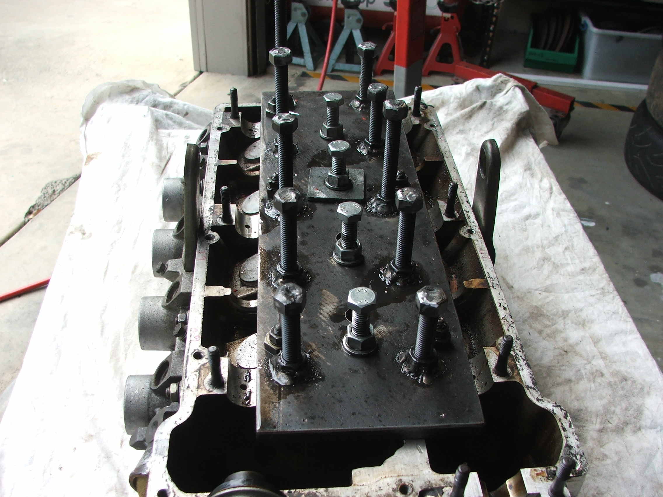

After working on the last engine for 3 days to try and coax the head off the block studs, it was decided to simply make an appropriate tool to force the head off.
The tool is made from 12mm steel plate. 4 Bolts engage the spark plug sockets. The six camlock studs are also engaged. the function of all bolts is to form a solid anchor to the head when separation pressure is applied.
The applied pressure comes from 10 x M10 threaded high tensile bolts that press directly onto the head studs. This pressure causes the head to move away from the block and eventually completely off it. The process during the final stages is aided by suspending the entire engine by the head anchors from an engine crane or a hoist arm.
Naturally copious use of penetrating fluid is obligatory as is a gradual pulling up process to be able to monitor the parallel upward movement of the head. Failing to do so will result in binding up of the head into the studs. Excessive applied pressure could strip the spark plug socket threads and pull out the camlock studs.
SO IF YOU MAKE ONE TO USE- GO GENTLY BENTLEY !!!

- Finally its off..JPG (231.45 KiB) Viewed 18162 times
- Twin Spark head removal homebrew tool 1.JPG (243.9 KiB) Viewed 18163 times

We used to hang these engines for days suspended over old tyres and just spraying WD40 down the bolts. Sometimes you would here a massive clonk in the night
The last engine ( nord) we could not split heads off no matter what even with a few bottle jacks .... Engine went to the bin !
Maybe spark erode the front and back studs to start off with ? Easier if some one made the "tool" !

So here I is to tell you the rest of the tale of push/pull head removal tool. Now this could take a zillion words or just one short You Tube video but I am reluctant presenter.
I think you will find the sequential photos are self evident. The main thing to keep in mind is the use of R12.5 rated threaded rod and nuts. Anything else will simply strip the threads due to the pressure involved.
The key objective here is to rescue the block and the head. If pistons and rods get damaged in the process, well, they can readily be replaced. Liners may or may not survive. Mine did.

more to the story...
Essentially it is a very slow and long winded process. Each bolt at the top has to have an equivalent number of turns at the bottom. The turns should be restricted to 1-1.5 turns per sequence. The bottom push rods locate on the piston wrist or gudgeon pin. Before you start, remove the spark plugs and wind some rope into the cylinder enough to cover the piston crown. This is to cushion the piston from the head so as not to damage the head.
DO NOT BE IN A HURRY. A really hard stuck head may take days to inch forward but it will come off.
The pattern for the holes to the bottom plate are transferred from the crankcase turned upside down on it and marked.
