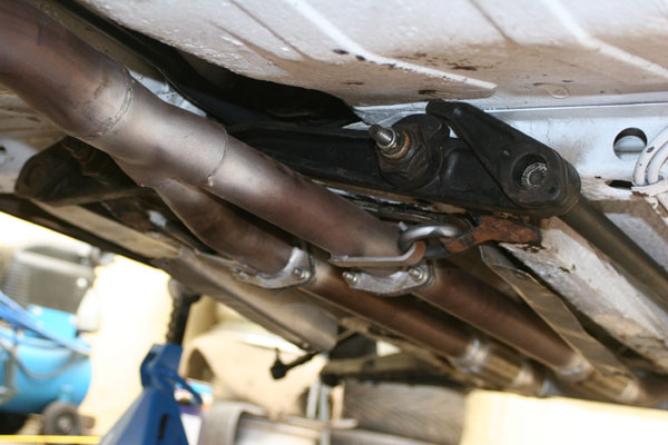

It definately would help to remove manifolds as the long studs into the down pipes are restricting it from coming off. I would cut the exhaust and put in two flanges at the downpipes for future. I know this pic is missing a box and cats but same concept.
