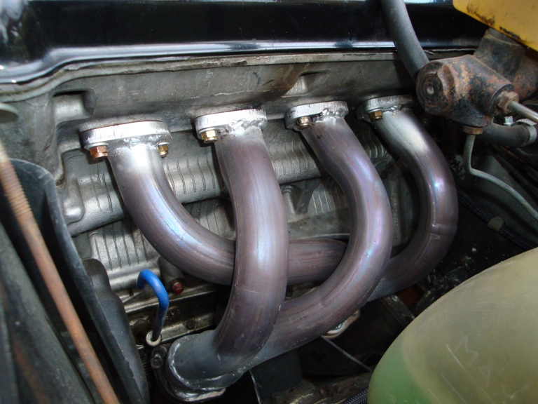

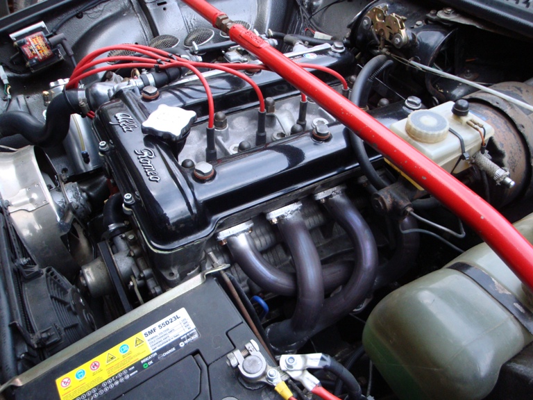

Some pics of my new stainless steel exhaust manifold.
Primaries measure 42mm OD and 38-40cm each in length.Secondaries are 45mm OD that become 50mm, then 55mm and merge into 60mm OD final.
2 free flow mufflers (middle and rear).
It definitely improved engine response through all gears and along with a change in venturi size (40mm from 37mm) has given more potential for further improvement.
I think that at last the time has come to dyno the car (although i already got some clues from the Desktop dyno simulator).
Stay tuned...

While you are on this rebuild /revival kick, why not strip down the brake master cylinder and the booster assy, sand blast it all and give it a nice paint job to make your engine bay consistant. While you are at it, install a heat shield between the headers and the brake master assy to reduce radiant heat cooking your brake fluid?

you are absolutely right about the heatshield and this in fact is on my top priority list for next week...
As for the master cylinder i myself hate its 100 year old looks but the fact that i use the car everyday for the last 7 months has prohibited a job which i am afraid will require a couple of days and leave me without any means of transportation...

Is the a stock Alfetta booster/servo? Looks like it came from a GTV6/90/75 V6

Well he said his booster looked like a 100 years old. Was wondering if the JGreekster whom you said lost some olives at the bus stop (with a trench coat I believe) drooled over it, causing the rust...
BTW X, was that mandrel bent? Looks nice. But how is it different than most other offerings? Is it the pipe size? Most manifolds I see for the 116 are like yours.

Re: Exhaust manifold (Nord)
Zamani,
yes they are mandrel bent.
Significant differences from the usual Ansa, Supersprint etc stuff are:
1)the intake port geometry which is far better in this one, and
2)the optimum lengths and diameters of the tubing let alone the far better shape...
Thing is that if you want the best manifold for a 116series 4cyl car the only solution is to try and make one (if only P. Spruell produced headers for our cars as well, things would be quite different though).

and yes Z the brake booster is indeed from a GTV6 (22mm) and not the standard Alfetta one (20mm).
