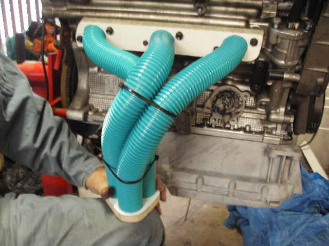

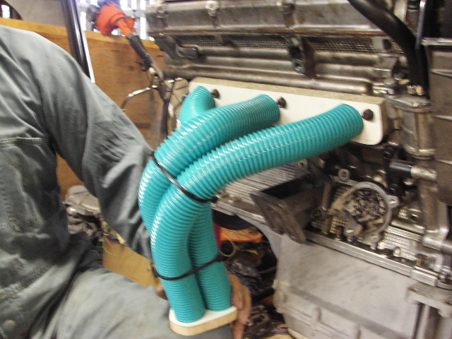

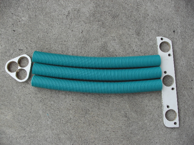

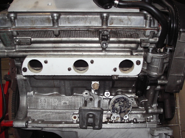

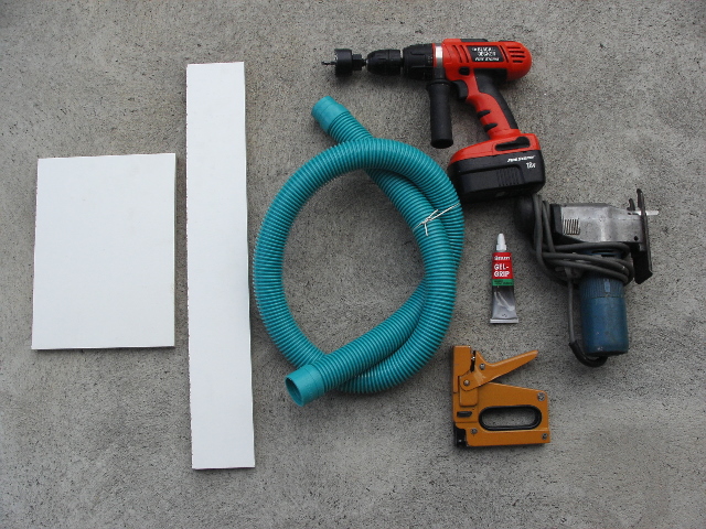

Well as promised, Daniel and I got together on the week end and had a bit of fun remaking the model for the primaries template.
Now remember, you have to do your homework about internal tube sizes and tuned lengths for your pupose. The point here is just to give you and idea of how to get started.
Tip: the vacuum hose you select should be as cheap and as compliant as possible. It will make the job easier to bend to shape.
When it's done, have some fun with it and not only bend it but twist it too and see that you can make quiete a variety of solutions. It may even inspire you to do other projects.
If you are also thinking of building a collector, you could join it at the primary flange as per the model.
Party time..get your play dough out kiddies..
Endeth part ONE
Items required.jpg (230.51 KiB) Viewed 18225 times

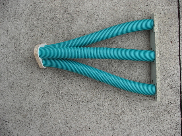

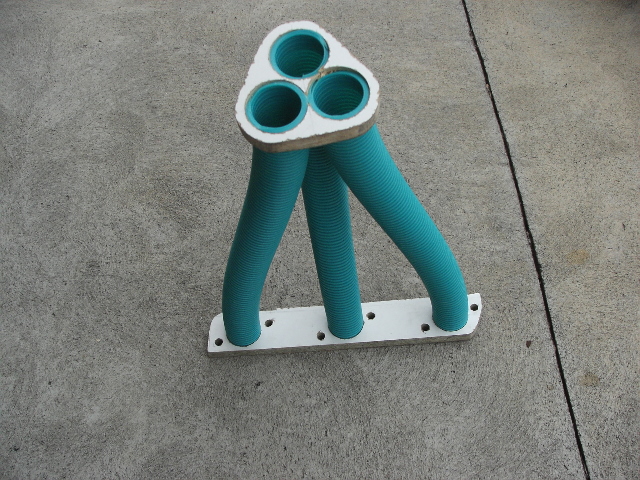

Starteth part TWO..

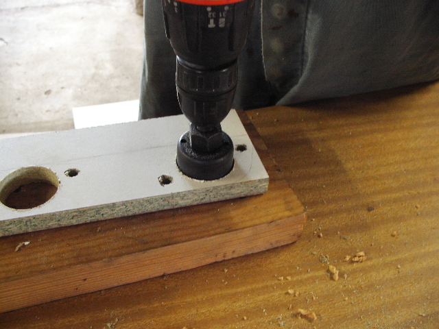

Once you cut the holes in your timber manifold faceplate, insert the tube and staple inside to retain it.Three staples is enough. Use some contact glue before hand if you intend to be rough in handling this item later.
BTW. Don't let me catch you even thinking about using real fexible pipe for your actual headers unless you want me come around and smack you on the back of the head with a borrowed KIWI thong for being a bird brain. You need SMOOTH internals man..
That was fun Daniel. Hope it inpsires a few out there to have a go.
As you can see, the V6 does not need a spaghetti weave going around the moon and back to work. It is one of the simplest there is. Don't let anyone charge you the earth to make it.

:D Not to steal your thunder Duck man,but you gotto do this in the car to check clearances...That nice 3 way flange of about 50mm dia.?Dem pipes gotto clear little space between engine and body...
Otherwise,bloody well done..(For an Aussie :D :D :D )
Hey,I like your floorpan/tunnel mod for the exhaust pipes... :!: :!:

Seriously this is a good idea. But clearence may be an issue if this is not built with the chassis.
When Larry (APE) built headers for the 24V he had just the engine bay of a gtv6 with the 24V in there. Of course being the owner of an Alfa wrecking yard, he has an advantage.
You guys have to remember, even exhaust shops have mandrel benders in Australia. This is unlike any other place in the world, so bends may not be an issue in Australia.

Flat bends yes but judging fron the pics you need helical bends, i.e. twisted bends like a spring.
