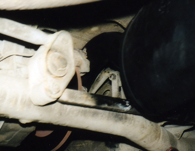

Greg Gordon wrote:Mats I am not calling you a liar. I have no doubts you got a 2.5" pipe in there. I would just like to see it.
Actually, I said 3". 8)
Found some old scans, before digital cams...
Not very good but they show what you want.
3" + old Supersprint back box.
3" right next to the caliper and AR-bar.
Re: Need tips building my new exhaust
Thanks Mats, that looks really good. I am going to try and shove a similar setup into a car soon. I didn't think it would fit.
It does. With a low car you will have some interference with the nut on the AR-bar but that is basically only when going over speedbumps and such excursions.
Keep the pipe close to the body and you need some stiff mounting points to keep it in check. It will give you some noise through the bodywork but I guess we're talking about a car that won't be used to go to the grocery store? :wink:

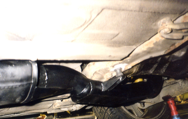

I had the car up on the lift today and checked around the rear part of the 2.5" exhaust pipe. There is definitely room for a 3" pipe, no problem, without crushing at all. With a lowered car, both 2.5 and 3"pipes will be too low somewhere in front of the gearbox but a separate flat and wide section with conical ends (with the same area as the pipe) should take care of that. As Mats says, a somewhat rigid mounting arrangement is necessary to prevent the system from banging around.
Like this you mean?
2" pipe sliced along it's lenght and sheet metal added to keep the cross section equal to a 3" round pipe.
Space saver.
Space saver.
Below the gearbox crossmember
Yes, something like that but with longer tapered sections before and after.
