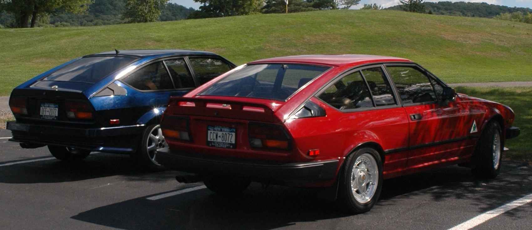

It's the blue car with the Zender kit, next to my red car we'll be building
