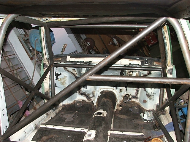

So when it comes to roll cages, all of a sudden the brains are out to lunch and you gotta buy one? Why not get a hold of the rules that apply for the type of event you want to be involved in your locality and using the approved design, make one yourself? What's with the freeze?
Here's a photo of the one I am currently building for my Alfetta sedan. Obviously it is in progress so keep that in mind. It is made from 44.4mm OD x 2.5mm wall CDS (cold drawn seamless) tube for the main hoop and 38 mm for the rest. OK, it's not a cakewalk but if you guys can transplant a 164 donk into a GTV6, you can do anything! Have go. It will save you thousands!
Cage in progress.jpg (200.88 KiB) Viewed 16775 times
