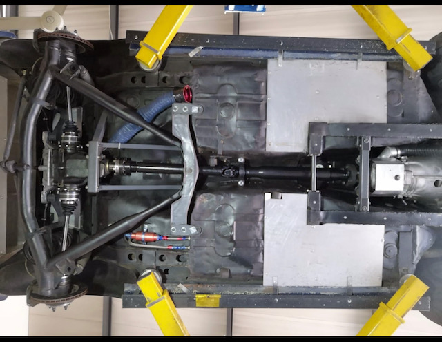

These are a few of the basic pics of the two cars. The "red" 12v one might be for a write up another time. Also a few pics to show the basic set up.

i have divided the photographs into sperate sections which I will download now. This GTV uses same flywheel and clutch as on my car. This set up works perfectly for using the BMW M5 performance clutch from Helix. This unit has the same spline count to suit the 5 speed E36 ZF gearbox. Pics show the basic alignment set up. Mario and Bjorn used the 188mm diff as this gives you far more options regarding final drive ratios unlike the limited ratios you get on the Alfa Sei. Diff ratios on the Alfa Sei diff can be found on this link

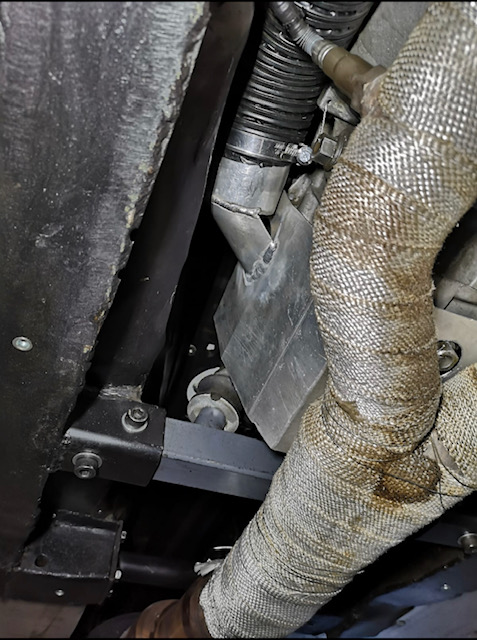

A nice cowl with air intake for the gearbox to keep temps down. The exhausts are wrapped at this point as well.
It must be noted that there are budgets that have to kept and unfortunately with the bad Rand at 23:1 to the Pound it's not an option to import well tuned headers made by the likes of Extreme Tuning BG.

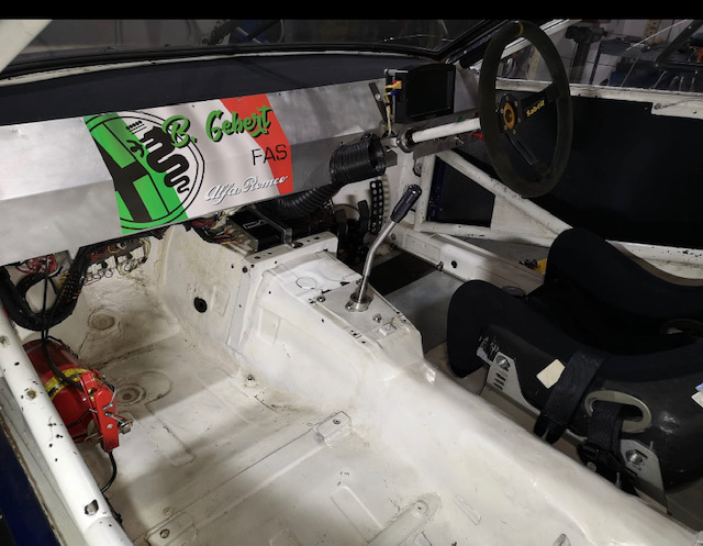

Some interior pics showing the steering rack quickener kit, accumulator and the heart of the system : - the Powermods V1 ECU.
Note the E36 tunnel stitched in.
