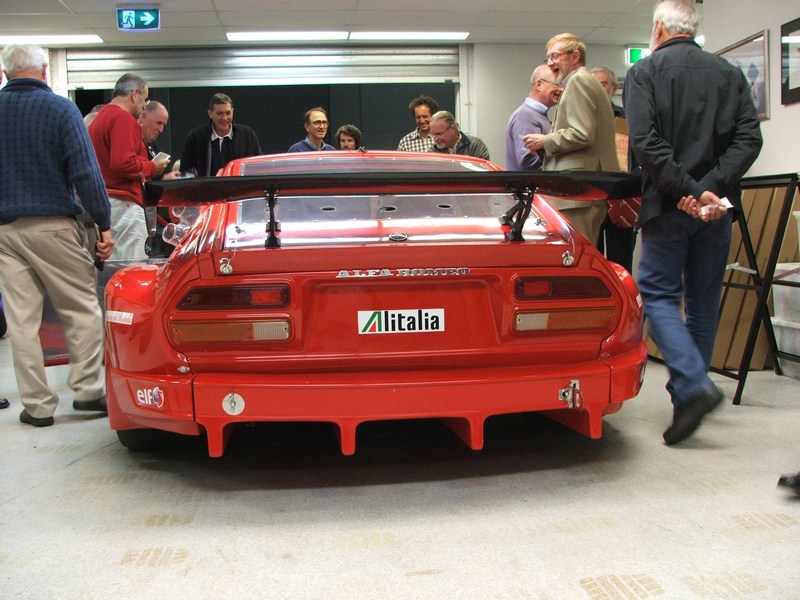

Here's a dedicated track car built by one of our local Alfa Car Club guys over a number of years. It has some history attached to it whereby the person who made it, sold it and eventually bought it back.
Alfetta turbo powered (15psi)with a regular transaxle doing the transmission work. Weighs just over 900kg. Gorgeous build quality.
Turbo Alfetta Race Car

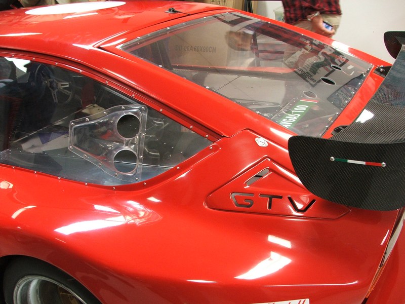

Some more..

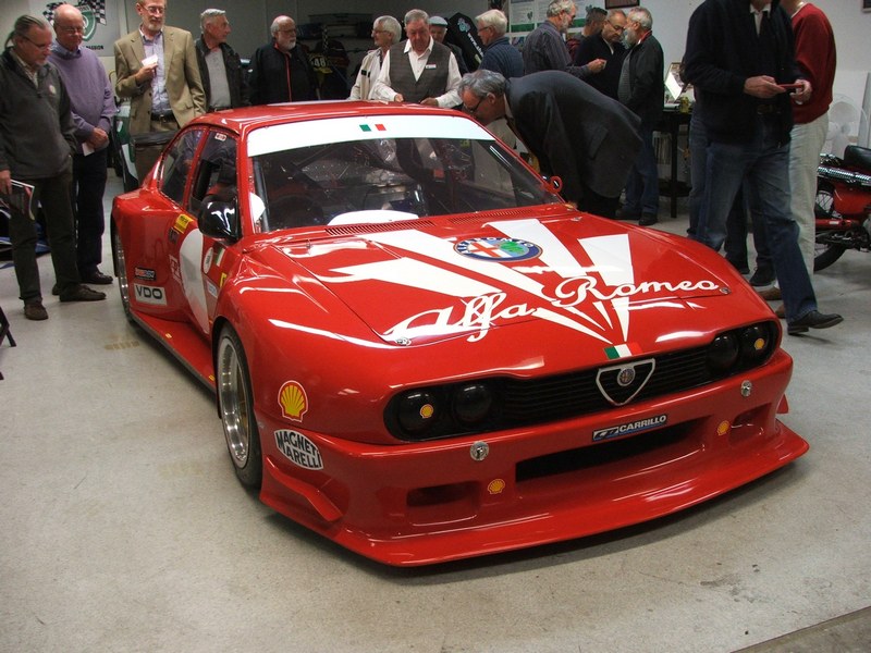

Re: Turbo Alfetta Race Car
On one hand it's an amazing build, on the other hand there is precious little Alfa left in the car. But as long as it shames the other marques on the track who am I to judge?

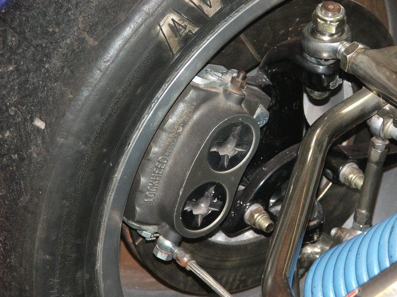

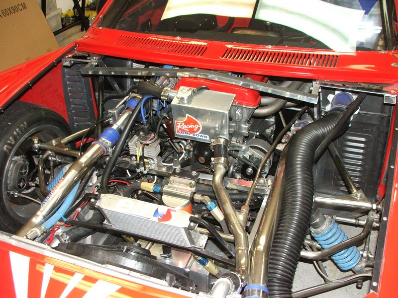

There's nome nice work there!
A couple of curiosities tho. Like the fact that 105 uprights are used, with 'upside down' lover ball joints (spherical rod ends), but no apparent bump steer correction.
Also, the steering arms are standard (LONG) length..............
I'm surprised that they didn't duct the radiator air flow out thru the bonnet and over the car. Maybe a rule thing?
Anyways, it's always great to see some of the gizzards of pure track cars!
