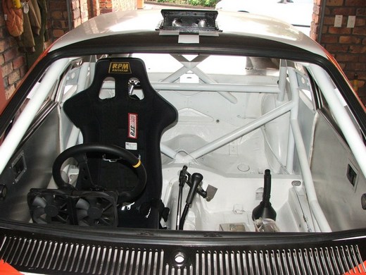

Can't show you too much 'cause the entire car is not yet finished. Certain parts are so I will post some of that as we go. Here's a photo of the office. Absolutley minimal. Not even a dashboard or a binnacle to hold the instruments. The "instruments" consist of 1 yellow shift light,2 red oil pressure light, 3 green engine temp light,4 blue alternator fail light and off course the tacho.
The computer fans are for cooling the driver while waiting in the hot Oz sun in the que before gridding up.

Niceee, quite a minimalistic approach to a dashboard!
I do prefer gauges and a low oil press light....just to monitor tendencies...
I spot a shifter convertion too?

I spot a roof vent and what looks to be spot light mounts - ex rally car?
Colour scheme, from what's shown, looks great!

I have quite a bit of more gauges then that (and lights) and my electrical system is insane compared to what you seem to have.
Is that a Megasquirt box I see?
White interior... Brave man. I guess you like cleaning?

Yeah white car to start with inside and out. I wasn't going to repaint it completely like the Brick.
Guages for road cars I agree with or race cars that participate in long races ie, Bathurst or indeed rally cars. The short laps that I expect to do, reviewing progressive issues with guages is not warranted. It either works or it doesn't. If it works you dont stop. If it doesn't you get off. If it is intermittent, you get off. Extra weight ,complexity and cost is not warranted. Everybody has their opinion about this and this just happens to be my take on it. We'll see how this theory goes.

Yeah the gauges are as you say just different approaches, for me it's a diagnostic tool. If you suddenly get "The Fear" in the middle of a stint and think there is something wrong you can glance over at the gauges and see a problem or a trend. I can't afford to stop after something has gone wrong.
I even have a fuel gauge...

On a more serious note, in my case if you can't make your gear last 6 short laps without overheating and losing oil pressure you are not ready to be on the track and shouldn't be there.
As for trends, its usually too busy in the office trying to stay ahead (or catch up) to be studying guages and if trends is what is needed, it's best to use data loggers don't you think?

I guess it goes on your preferences really, i'm with mats as far as the gauge thing goes even though I clearly understand what you mean, it's not over one race that you look at the trends though, it can be replaced by data logging, but it's something psychologically reasuring to see the gauges after all the time, effort and money spend on building an engine....

A screwdriver is the normal fuel gauge around here (to compress the foam) but I plan to have the tank under the floor and use the stock filler location (due to regulations, if I have a filler inside the trunk I need a water tight wall in between the cabin and boot...) so it will be quite difficult to check level with a hose.
As far as I'm concerned I have built a new engine in a configuration I have never seen before so I have no idea if it will take 6 laps of the town sqare...
I'm not planning on looking at the gauge all the time but I will certainly have a look entering the long straights and just before braking, do that every lap and you will see if the temp stabilize or not. And yes, I will naturally log on both my DTA and my DL1 (planning a CAN-interface too) but then I can see if it went to hell, with a gauge I can catch it before overheating the water or oil or see if the boost drops indicating a leak instead of overspeeding the turbo and maybe shredding it.
I like approaching from the chaotic side instead of the over-engineered side but that's just me.

you should have plenty of ventilation = those roof vents are very effective and tend to minimise dust and exhaust fumes by picking up high. will also help for keeping the screen clear on humid wet days.
