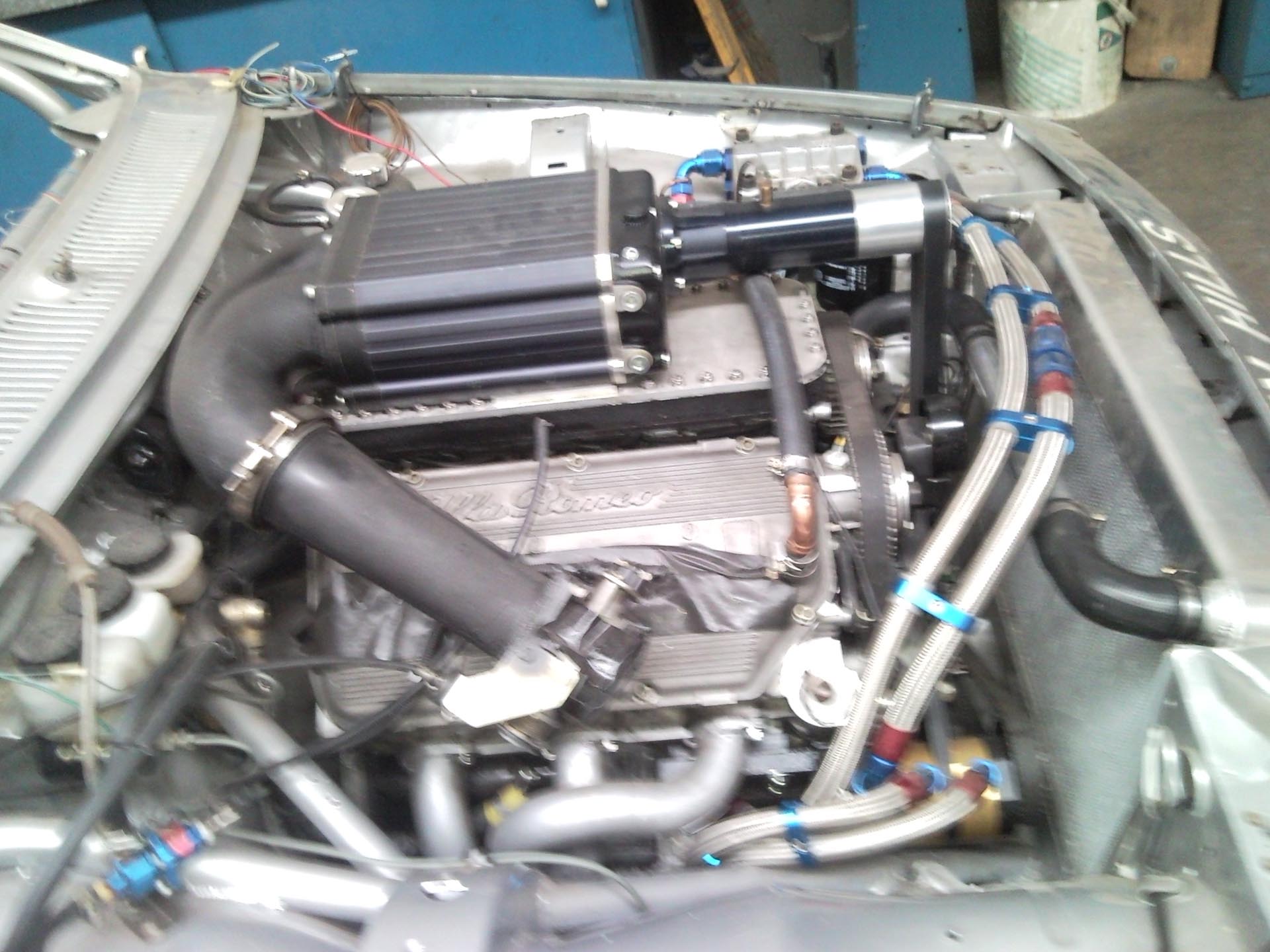

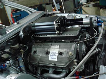

I am always happy to see a supercharging project underway. That's a nice looking Lysholm unit. I guess you are making a special hood, it should look really mean. It will sound mean too!

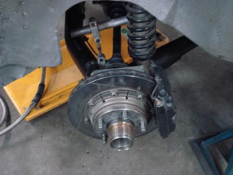

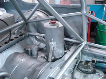

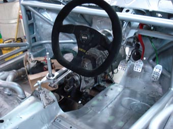

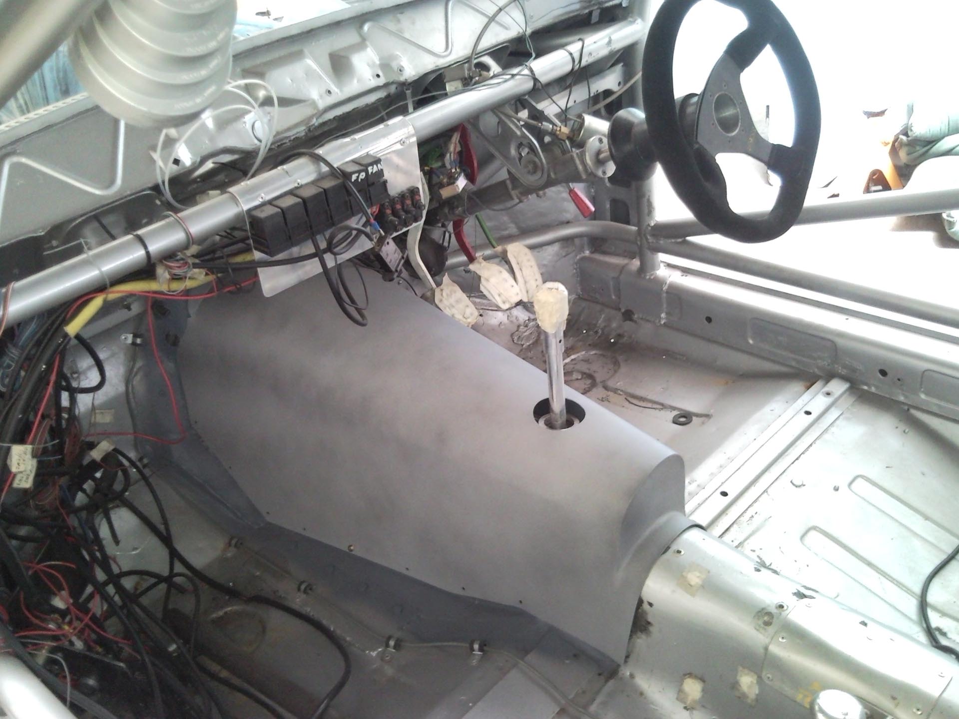

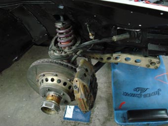

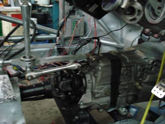

In addition to Supercharger, the engine is dry sumped, uses front mounted gearbox
Alfa Sei diff with LSD and Imsa 75 de-dion which fully adjustable i.e. castor camber, toe in as wll as Imsa 75 Brakes
To adress transmission outputs, installation of front mounted gearbox and Alfa Sei Diff

Hi Greg, hood will be custom made based on South African 3 litre GTV6

Which Getrag is that? looks like a BMW unit.

Is this going to be intercooled? What size is that supercharger, how much compression and boost are you planning on?

I guess the gearbox in non-Alfa.
However, I couldn't care less. If making a good car requires some foreign parts I'm all for it.
Re: V6 Supercharge Engine Racecar
Oh, I read too fast, thought it was from a Sei.
Anyway, as long as it has an Alfa engine...

MD the reason for front mounted gearbox is the transaxle wont handle the 500 + HP, obviously you are nowhere near the limits of BIG HP, Alfa dont make a gearbox that will do the job short of purchasing a $30,000 hewland transaxle, as for your other comments about not being an Alfa is pure Alfa, the only non Alfa part being gearbox. Even Autodelta/Alfa Corse used Hewland internals in their Supertourer gearboxes, this is a "sports sedan" but still retains monocoque construction. do you race with VRA? they wont allow the fast cars to run afraid of being beaten!

That's an impressive supercharger setup. Obviously it's not going to fit under a stock hood, but it will probably fit under one of the Group 4 turbodelta type hoods.
