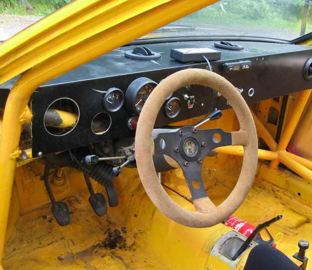

Here's my current:
rpm
oil pressure light
oil pressure
oil temp
water temp
A/F meter
Intake air temp
sorry for the bad picture and car is (of course) UC
Here's the new coming in:

- GTV Dashboard.jpg (46.41 KiB) Viewed 5065 times
