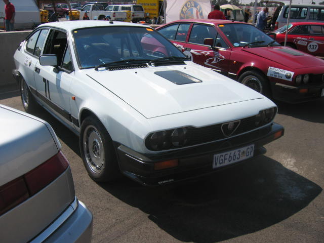

Mats, added some lathed spacers on to the rear shocks(25mm) to give me about 45mm of droop. No problem with springs relocating off there seats. Had very good racing today with no problems. I have also noticed that my rear brake lock up problem only occured on a particular straight which is more bumpy than usual through the braking zone(purposely done- no its not a motocross track).
Problem solved and thanks for input.
I will put pics up of a 'cup' I made for the rear springs(not RS) on the 24v as this was a problem for road use only.(springs coming out seats).
Pic from track.
