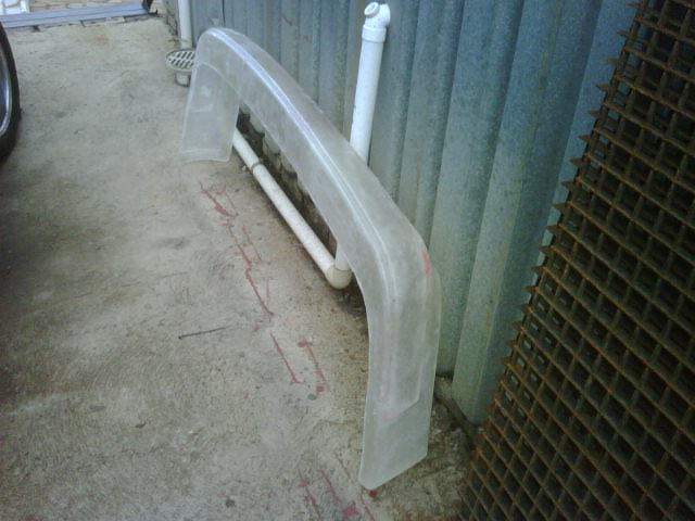

Any way back to Race cars check my new lightweight rear bumper. Its so dam light , barely makes the scale go down. Its made from polyester.
Some of probably ask why the effort when it can be removed but its silhouette racing here in this catergory. Wait until you see my whole front bumber combined GTV3.0L spoiler.
- rear bumper.jpg (53.33 KiB) Viewed 7189 times

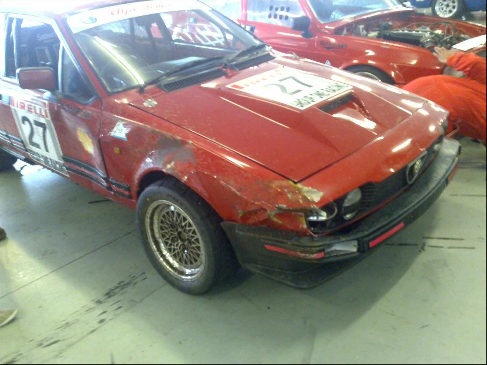

''bumber'' thats what happened to Konrads car today in the rain . The first customer to the new nose section.
- konradsgtv.jpg (133.14 KiB) Viewed 7192 times
Understeer into tires?
Oversteer turn two Kyalami in qualifying. Believe it or not ,it was the first wet race in three years. None of the four accidents were understeer , all the back stepping out BUT we found out the there was a lot of oil left on the cicuit from a previous race which the marshalls did not pick up in the downpour. At least Konrad did a bit fender straightening and got out there to finish 8th in next race after spinning twice more (in the first lap). That 3.0 carbi has so much torque.
