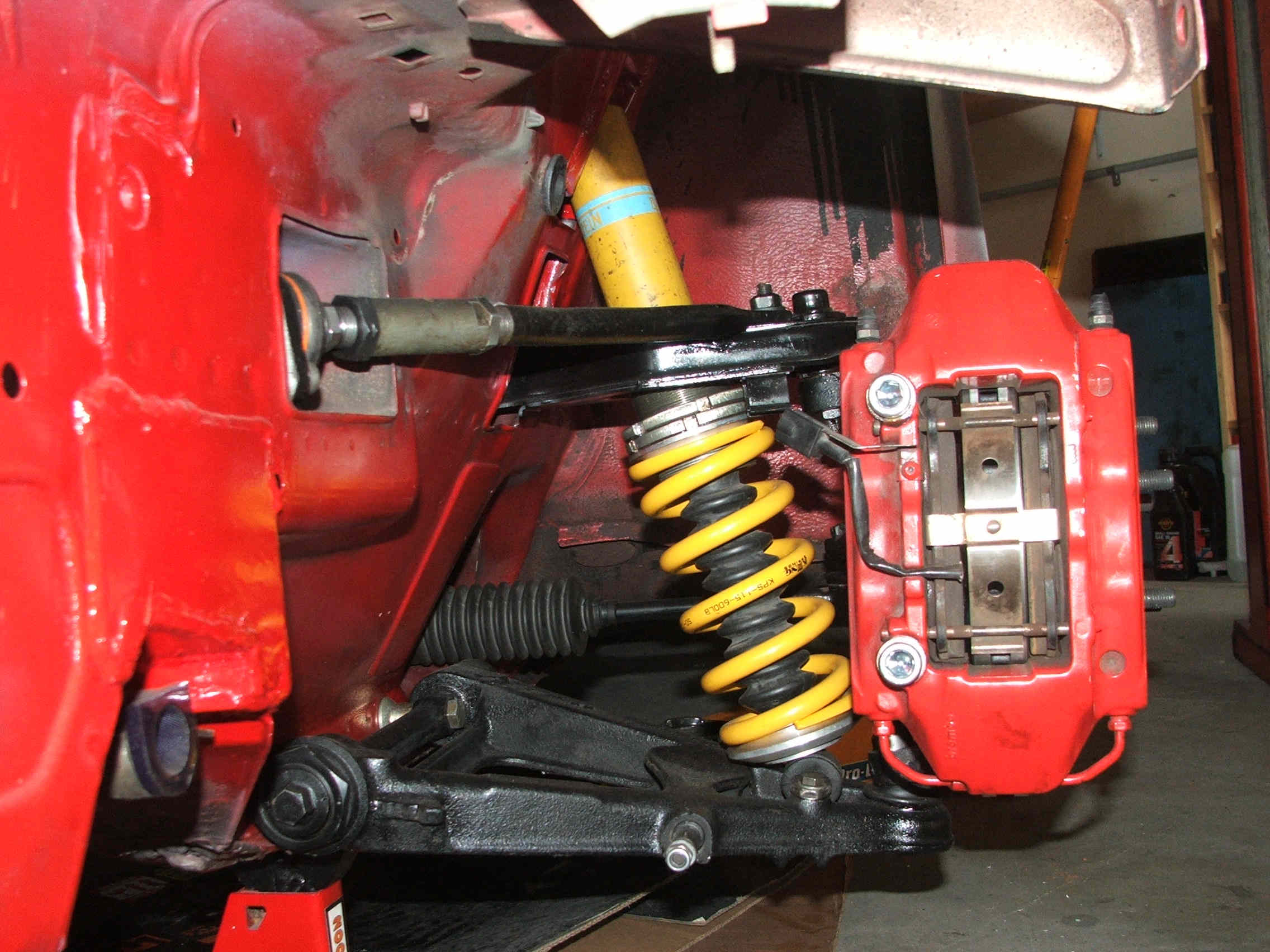

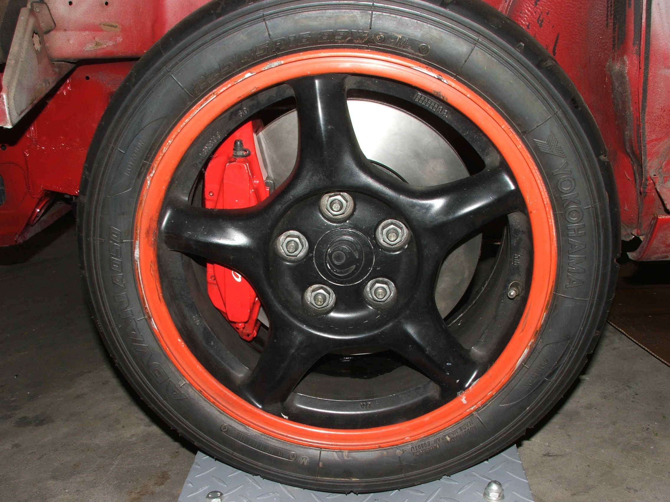

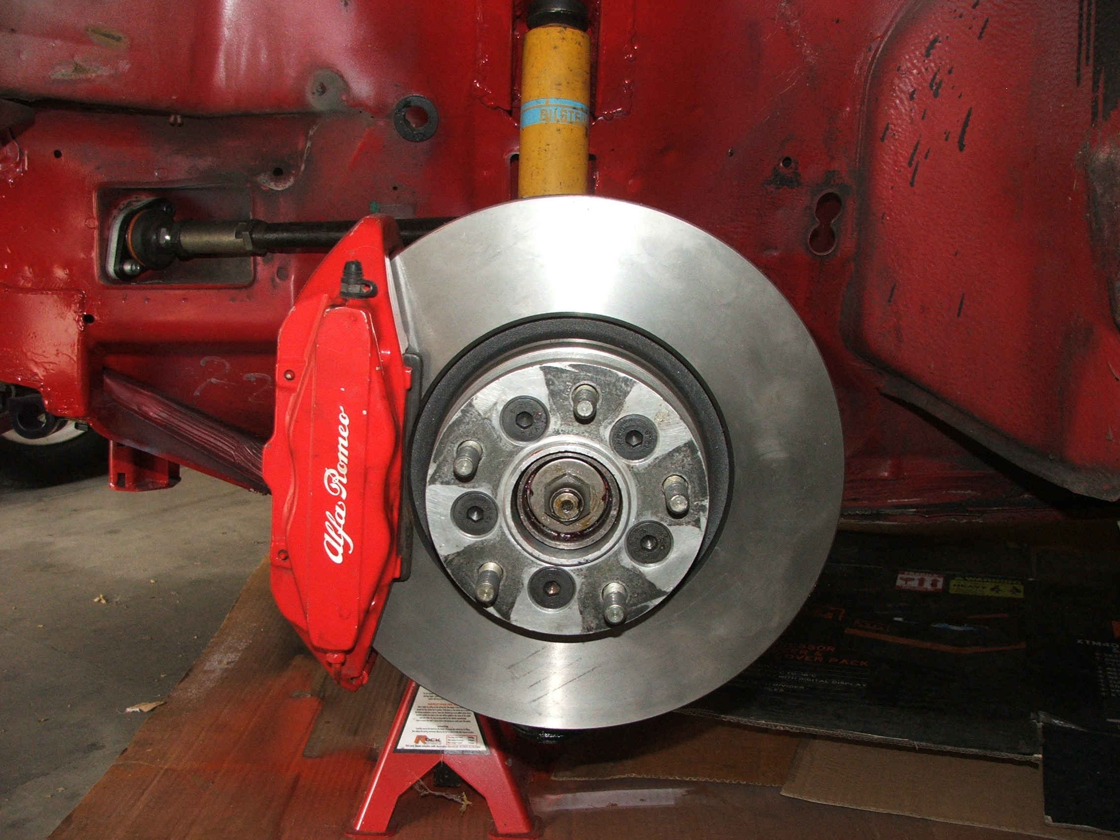

Here's a couple pics to refocus. Nothing really 25th century new just more of the same practical stuff. The only subtle difference is in the coil over. Looks "sort of normal" but it isn't. The damper is upside down. This means the coil does not move through the upper control arm. There is no need for any enlargement of the opening in the arm for clearance. The spring works between the upper and lower control arms only.
Everybody needs to thank our Daniel for creating this stuff.

I know the rims look a bit lame but the reality is that they are a true magnesium alloy and they are especially lightweight so function is taking priority over appearance. Thank you Mr Mazda.

MD, just a question on that coil over. I could never start the spring so low down near the lower A arm because it would clash with the steering arm that comes off the stub axe so it had to start like 60mm higher . If I could have solved that then I would not have needed to open up the upper control arm.

Hi Kevin,
Good to hear from you. I don't recollect seeing your coil over set up. However I will just mention a couple of things.
1. The springs I use have a small radius 65mm ID.
2. The damper is an upside-down version so it requires little room below the UCA.
These short and small diameter springs can rate as high as 1600lbs/in.
Worth keeping in mind that the caster limit is about 3.5* before there is assembly contact with inner part of the UCA . Suit me fine . For more caster, the UCA would need provision for more clearance.
How does yours compare to this?
