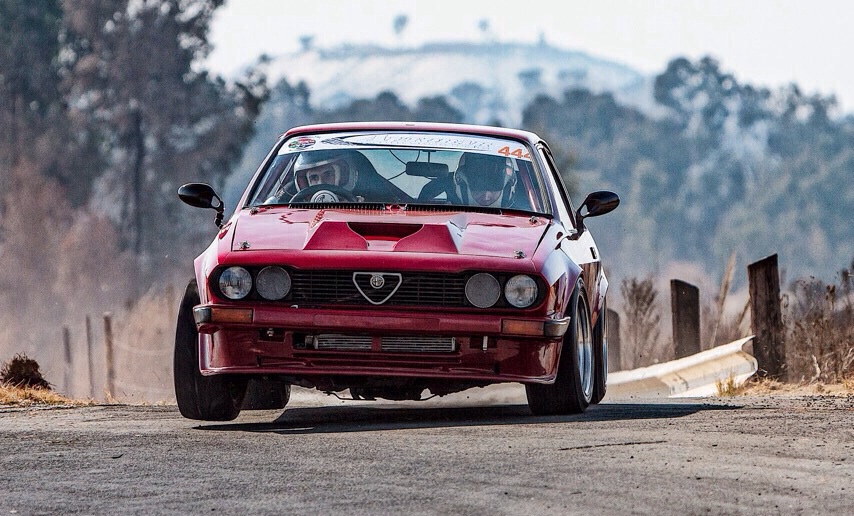

This car which is same as above is for sale in SA . Here's an action shot from few weeks back .

huh.... where is this?
Re: Race Animal ?
It was Scoobie day at Z . Dawie got Braam to drive . This car does not run coil overs but keeps torsion bars with RS springs in a cup type holder between lower A arm and reinforced bump stop . Clever way of getting around the " not having coil overs in rules " . Got some pics somewhere ...

any more pics of the car?...it looks perfect. What does it means Scoobie day - does it mean rally event?

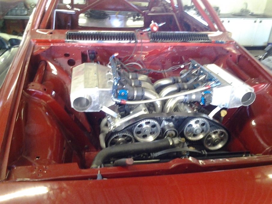

We've been waiting a while for Franco to complete this car . It's first competitive outing in the South African exotic super car series is this weekend . Most cars in this series start at 700hp up 1000hp .
Some pics of this longitudinal mount 24v 3.7 twin turbo .

what did they do to make it a RWD?

It's RWD as you can see engine has been turned around . I think it's using a Jerico box but I will ask him for some pics .
