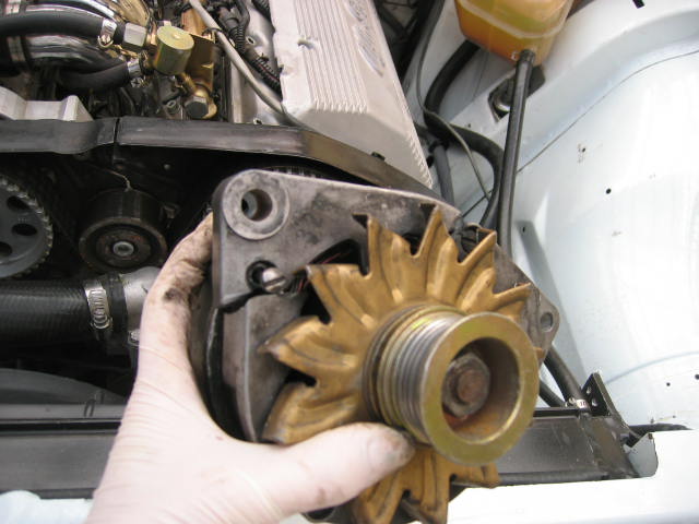

On seperate note I removed a broken alternator before the race. I have had one break like this before any one have any ideas.

Can't say for sure (who can?) but as a precaution I would be fitting a much bigger pulley and slow down the speed of the alternator by half.
Maybe you need to beef up the outer alternator bracket a bit. Looks like the thing is vibrating fore and aft and then giving up over time.

MD, I have used same size pulley as on the modern alfas - is this incorrect assumption. The marks on the cooling fan and the long screw indicate one of the long bolts came loose at some stage beforei got it and then it was tightened . Maybe shockwaves from the constant hitting led to some hairline stress fractures which have only come out now. Funny thing is i drove 30km like this with the alternator still charging perfectly. I rechecked alignment of all brackets for any unnecessary stresses induced - all perfect.

Classically, rally cars are always fitted up with megawatts of lighting when doing night work and they usually need some serious alternators to power them. The current loads on these things get very high and so internal heat becomes critical. What's this got to do with your set up ? Sweet FA.
You need the opposite. Minimal size alternator just enough to supply voltage and current to match the load while running. Less engine load and less weight. So when you combine all that and include in the set up a larger pulley, the alternator will not run at multiples of engine revs like 15-18,ooo rpm and thereby thrash itself to pieces but instead it will run at less stressed speed and have less likelyhood of throwing cores out the side and bearing failure which ultimately causes the hole guts to fail.
Simply, road car occasional high rpm is ok. Sustained high rpm for racing will cause them to die.

MD, youre invited but just stay away from my beer ! Right I have ordered the bigger pulley wheel now that you have explained it so clearly.

I had an RS2000 with 600 watts of light and a bigger alternator fitted (not a rally car, I just used to do a lot of country miles). It was constantly breaking the main lead, we guessed through vibration. A mount was redone with some rubber mounting put in place and it never happened again. Perhaps this may also help your issue?
