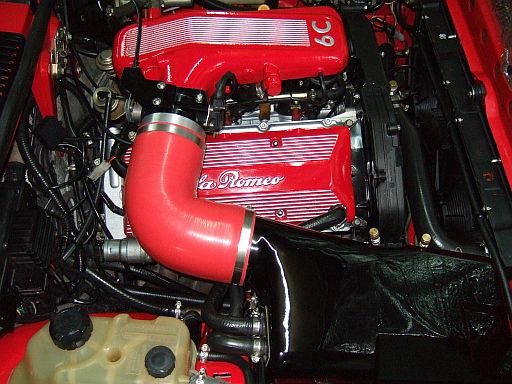

I also saw your dyno video of the GTV6 3.7. How about this airbox? It has 4" pipe out of the airbox and you can either get a 3" to 4" reducer silicone hose or a 4" hose with a 4" aluminum adapter pressed onto the stock throttle body. Very nicely made in case you are interested.

- Beninca Airbox from Petros Bond's car (photos by Petros)
