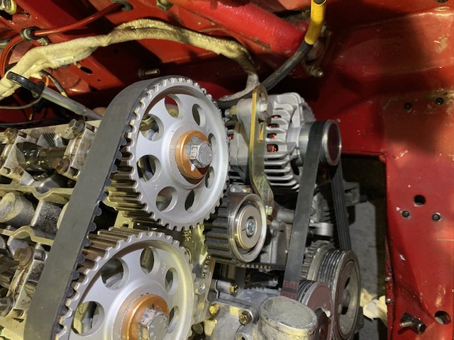

Next up was new water pump, thermostat conversion from Jim’s latest book, a proper fan and fresh pipework.

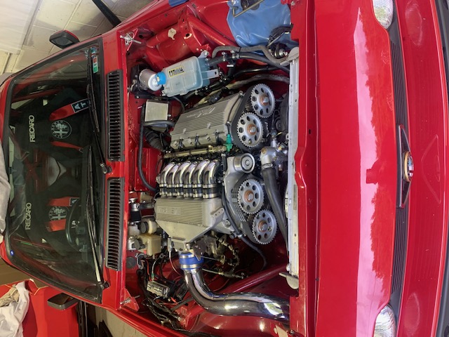

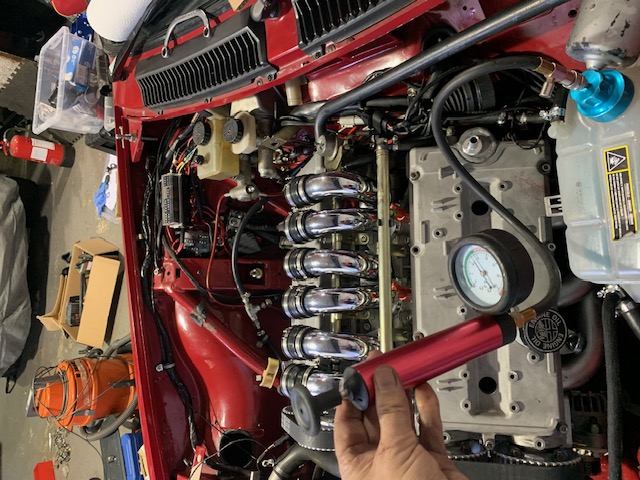

One Humpty Dumpty was back together I pressure tested the water system system and just check did a static compression test. Well I did find water leak out of bottle so good news that was all

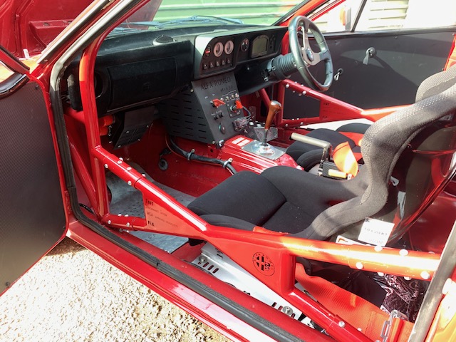

Now it’s back to dyno to remap the new injectors . Probably only in new year. Some interior pics and that’s all. Comments welcome

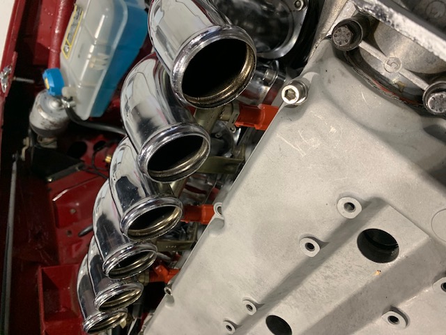

Yep ! All the cloning in FB is bullshit ! It definitely has its place .
I need to do a full post on the throttle body set up !!
